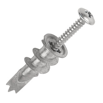

I've just bought some Screwfix 32mm, self drill metal plasterboard fixings branded EASYFIX, like below:-
I have now used 9 of these in a plasterboard (Paramount) wall. 5 have proved impossible to install and have made a mess of the wall. This is a near 50% failure rate! The screws that come in the box have to cut their own threads into the metal fixing as they are tightened. The metal is quite resilient and it takes a great deal of effort /torque to finish the screw. As you apply a lot of torque to drive home the screw, the entire metal fixing continues to rotate in the plasterboard. It eventually either drills right through the plasterboard layer, or strips the plaster thread and just spins. You end up with a large hole either way, and the fixing has to be withdrawn with pliers.

I have to say that I've had far greater success with the parasol type crushable metal plugs, although they really require a setting tool for most reliable results

Nothing could be easier. Except when the screws don't go into the plugs. Well they do if you use a ½" ratchet. It takes so much force to drive the screw home that the plasterboard fails around the fixing. Screwfix man said he was unaware of this and I believe him. However, as I type this reply, "Similar Threads" is showing 5 other threads that deal with the same issue, the last being from this April. Proves that I'm not a nutter. I suspect that it's just the odd box /batch. Stuff happens...
The screws cut their own thread in to the plug - which is soft metal. So once started they normally just fly in, but they do need to be started - which is probably the most difficult bit.
The only probelm I've ever had with these is the skim plaster cracking at times, but yes bad batches are possible but I don't think that its a common probelm with this type of fixing

In total agreement with you. For paid work I generally refuse to use them ("curly whirlies") because with the plasterboard being an unknown quantity in many cases the inconsistency of this type of fastening makes their use potentially very costly

Guys, from your varying comments, it seems that this is not unexpected. I'll shy away from them in the future. Those new GripIt plastic ones look interesting...
I only have good things to say about them
Hmm. Are the things you fix thin or thick? To be honest, I've actually found my problem putting up very thin material (1mm). I'm beginning to wonder if it's difficult to drive the screw all the way in that's problematic. Most people probably put up stuff thicker than 1mm...
