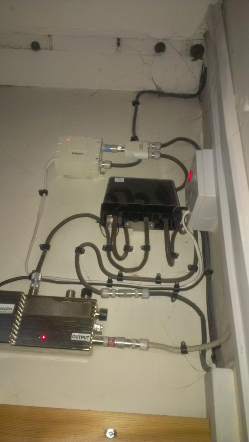

Near the loft, there is a "Clapham Junction" of wires connecting to three boxes which I guess distributes the aerial signal to the various aerial sockets round the house?
. I attach a picture. I'd be grateful for any explanation of the set up:
For example:
1. is the top cable the aerial signal coming in?
2. This cable then goes into the top white box which is powered - the socket marked TV has a splitter attached with a cable going into the middle black box and the other going off somewhere - what's the function of these boxes?
3. There are a no of cables coming out of the black box going into the bottom box - again, what does this box do?
How do I work out whether my aerial needs replacing or whether its one of the boxes by the loft? and secondly, how do I get sky in the other rooms?
Any help/explanation appreciated as I'd like to understand the set up and hopefully get it working.

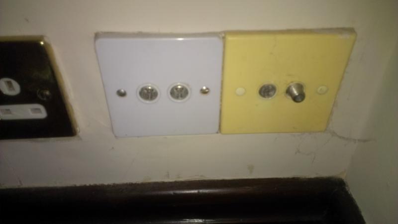

The UHF output from the Sky box must get sent from the Sky box back up to the distribution somehow, possibly through the white Y-thing on the top Labgear box. This may be through a socket marked 'return' in the lounge. It might not be on TV CH6 unless your Sky box and TV is tuned the same way as the previous occupants' which is unlikely.
However whoever installed that lash-up has used TV aerial cable, not satellite, as far as I can see, which a combination of amplification and attenuation, poor cable layout and tightly bent cables, unnecessary coupler etc.

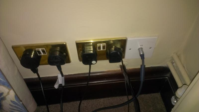

I have taken pictures of the sockets in the two lounge rooms downstairs. As you say, the UHF signal from the skybox must get fed back to distribution box somehow - well one room has just ONE aerial type socket (plus 2 sky cables). The other room has two panels with two sockets each - None of them have any markings on them. Any further pointers appreciated.

I can tell you what most of this gear is, and how it would normally be used. Your Heath Robinson lash-up might not follow the rules though, so be prepared to do a little cable detective work rather than taking the following as gospel for your installation. Here we go....
The top white Labgear box is a power supply. I would expect to see one of these where there is a masthead aerial amplifier (i.e. a booster box attached to the aerial mast). The IN would be the feed from the aerial via the masthead amp. The same cable carries power back up to the masthead amp. This is called phantom powering.
The OUT from the Labgear box looks like it goes to a two-way splitter My best guess is that one of those outputs feeds a nearby socket. The other looks like it goes to the left-most input on the black box.
The black box closely resembles an Antiference masthead amp. The things that look like spark plug covers on the cables haven't been used on your install, hence the minor difference in the images. The power for this is usually phantom supplied up one of the output leads. This would explain the presence of the "Taldis" box. It is the phantom power supply for the Antiference amp/splitter.
Your Sky box RF2 feed has been introduced some way in to that system. Generally we would take the aerial feed (with any amplification if necessary) and feed that in to the Sky RF input. Then take RF2 out and put that in to a powered splitter. If you would like to control the Sky box using Sky IR eyes then the splitter must have "DC Pass".

I have had a good look at the Heath Robinson setup. Your analysis of the gear is spot on. The black box says "Antiference UF3730 UHF Combiner 21-37/39-69. The connections are as you described.
Three cables are going downstairs - one from the splitter connected to Labgear marked TV. One from the right connector on the Antiference and one from the Output connector on the Taldis.
The Top outlet from Labgear is marked TV and the bottom - Aerial. The cable coming from the roof is connected to the Aerial.
The cables look OK and they were working before. I cant get onto the roof to look at the aerial.

Connecting a TV direct to the Top Labgear output marked TV works perfectly. Looking closely, the splitter connection was actually a Belling, otherwise known as an IEC ;)
So this means that aerial is OK. I tried with two different TVs and the signal quality improved to 91 and I could get all channels without any pixiltion or sound distortion.
So what next? Do I now move to the black box in the middle?
I don't see the point of the "Antiference UF3730 UHF Combiner 21-37/39-69" unless it's being used as a bandpass filter. You have a UHF TV aerial and a VHF radio aerial and this "diplexer" won't handle radio. So you can safely eliminate it and connect the UHF aerial direct.
The usual cause of sudden failure is the power supply or the amplifier that it's powering. PSUs fail through overheating and/or capacitor failure. Amplifiers fail through water ingress (outside). My money is on the PSU so measure its output voltage with a multimeter.
