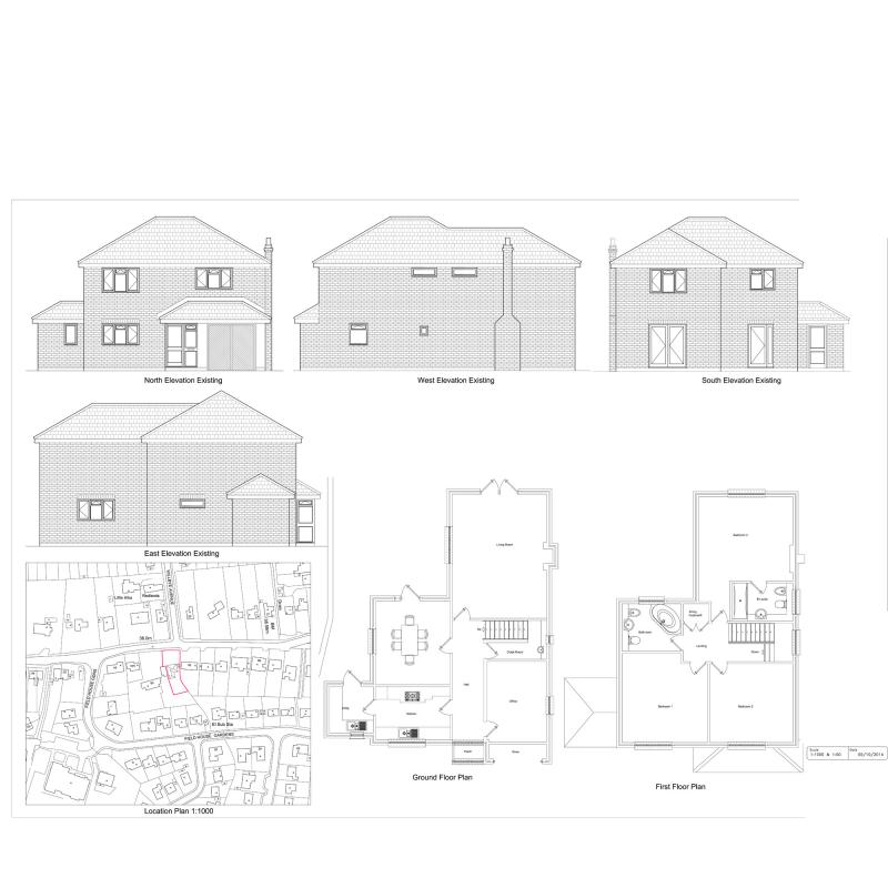

Not being much of an expert in this field (Well i'm not at all). We're going to be submitting the attached into planning next week.
Before we put into planning we'd be keen to see if anyone can help with spotting concerns with the planning application. The guy we are using is from Scotland and is not 100% familiar with English planning.
There are 2 images Existing and proposed.
I'd really appreciate it if you could advise of any concerns you may have with the application.
Thank you in advance
Rik
They look fine for a typical set of domestic planning application drawings.
However, whether or not the extension would conform to your council's planning policy guidelines is another matter.
