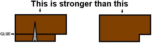

Good afternoon all.
I've just joined the forum as I'm wondering if somebody could offer me some basic carpentry advice.
I'm restoring an old Victorian property one room at a time. (I'm not a tradesman by any means but I'm fairly handy and can normally scrape by on a little bit of self taught know how - especially if I can pick the right people's brains!) I'm using as many reclaimed materials as possible, especially doors, for the authenticity aspect. One of the next jobs on the list is to replace the back door and frame. I've managed to source an original external door from a similar house a few doors away which I've had dipped to remove the old paint. I'm getting rid of the knackered UPVC one which was put in by a previous owner and basically putting the house back in period, how it should be.
Anyhow, the door thickness is 40mm. I'm going to be making the frame for it out of two pieces of timber screwed together, the front piece protruding 10mm to form a door stop, the other piece thick enough to form the rebate. What I need to know is how thick do I need the back piece to be to set the rebate? Do I do it the exact width of the door say 40mm or does it need to be a bit deeper for whatever reason, I.e allowing extra for paint thickness, both on the frame and door, or maybe to prevent the back edge of the door catching on the stop when opening and closing. If so, what depth would you do it?

I would make the rebate about 42mm. It is less objectionable if the door sits a little too far into the rebate, than if it sticks out a bit.
But have you considered making casing from three boards instead, then adding another three boards on top to create the doorstop? That way you can make the doorstop fit exactly to the door after it is hung...
If the door width is 880mm. How big should I make the opening?
Allow for about 3mm gap all round. However, I would make the opening fractionally too small, then plane the door a bit. Last thing you want is for the opening to be too big.

External door frames have stuck rebates made from solid stuff - you dont plant stops or anything else on an external frame.

I don't see why they're unsuitable, as long as they're wide? Glued and screwed they will be stronger than a solid piece of timber.

I have both solid and planted in my house. I don't see the problem, and I don't understand why you can't just explain it to us?
(NB: the planted door stops are not just thin strips of moulding, they are boards the full width of the casing)

Like it or not Vinn is actually quite correct - a planted-on stop piece is completely unsuitable for an exterior door for a number of reasons (e.g strength, durability, draught exclusion, weather sealing, insulation, noise transmission, etc, etc). A rebate needs to be 3 to 4mm more than the thickness of an unfinished door to allow for the paint or lacquer, possibly more if a sealing strip such as Schlegel Aquamac 21 is incorporated and you should also take into account the need for the door to be able move with seasonal changes in weather, etc , BUT the hung door should have the rear surface absolutely dead flush with the face of the frame and it is never "less objectionable if the door sits a little too far into the rebate, than if it sticks out a bit" - it's just plain wrong (not to mention badly hung and more difficullt to fit a lock into). In fact if youy hang a door correctly it will actually end upflush to the frame at the hinge side and in doing so is less likely to bind, etc
Sorry, Gerry, but you are wrong there. They are less strong. Try cutting a few dozen door frames out on a refurb and you'll get the picture.
