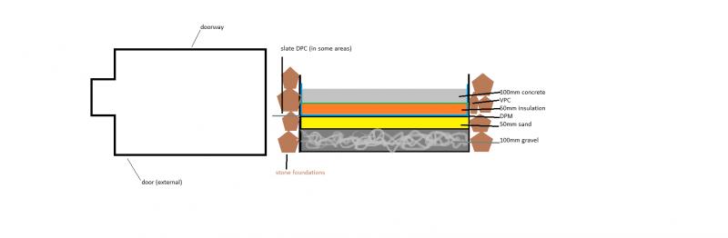

Ok.. We're renovating a house and (now wishing we'd just left them) dug up the existing concrete floors in order to put a DPM and insulation in.
We've dug out to 13" and have the following setup planned:
100mm (4") Gravel (already in & compacted)
50mm (2") Sand (already in & compacted)
DPM
50mm insulation (the BCO has said this is fine.. I know now that it should be more..)
VPC
100mm (4") Concrete
We're not laying a screed, but we are laying slate. When we refit the skirting, if there's a bit of a difference between previous and current floor levels, we'll move the skirting to account for it!
We're about to put the DPM in and I can't find consistent answers to the following questions. For the record, our BCO is known (infamously) for being a stickler, so I really don't want to get this wrong. We're in Wales (Carmarthenshire) if that helps anyone with regards to regs.
1- How far up should the DPM come?
Obviously enough to come up the side of the concrete, and I know that in ideal situation, the DPM would lap into the DPC.. Which leads me on to:
2- However, we're in the valleys and the existing DPC is slate (in some places, in others it's non existent). So where do we lap the DPM in to? Or do we just mortar over it onto the walls (a bit like render and flashing externally)?
The DPM is 1200 gauge and we have some tricky corners; currently we're just origami-ing them into a fold and then taping to the wall or DPM in the alcove under the premise that we don't want to cut it and the weight of the concrete will keep it in place once it's poured.
I've attached a pic of the room (nicely drawn in paint!) to show the alcove area. My husband has cut a square piece covering the room and then an insert piece which laps under the main square piece in order to fit in the alcove. This seems to be overlapped several times and we've made sure it feeds under the main DMP so that in the very unlikely event of damp coming in, it would feed under the main DPM and not on top of it.
If that doesn't make sense, let me know and I'll try and take a photo (or better still another paint scribble!).
Thanks in advance for your help :)
Bel
I'm not sure if the pic will show here but it's in my album otherwise!

You should have insulation at all perimeters ie. edging insulation located inside the membrane.
Section drawings/sketches should be made noting all previous FFL's and exterior GL's, and in-place DPC. Any variation with the new FFL's to the previous FFL's will bring various difficulties, eg. door thresholds.
Just flash the membrane up the wall above proposed FFL. There are sealers and tapes for joining membranes.

I know what I'm doing with the slab itself but is there a requirement for a certain length of DPM over the level of the new floor? Does it need to be 2" or so extra, or is it just so long as it goes past the floor level?

Do not cut the DPM 1200 gauge until after the concrete has gone off, I fix it in place by nailing to the wall well above the finish height of the concrete, then after I've laid the screed or whatever go around with a Stanly knife at finished floor level.
