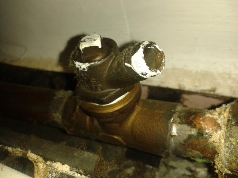

Morning all,
Sure this will be a quick one for someone to answer........
I've searched high and low on the pipe work for a drain point and there is definitely not one on any of the downstairs radiators.
The only one I have found is this one which is located on the pipework at the side of the boiler (downstairs):
2 questions really - is this the drain point that I need to use and secondly will this drain the downstairs radiators considering that this valve is higher than the downstairs rads?
If it helps I have system with a header tank in the loft.
If you need to drain down the d/s rads then you will need to either find a drain point at the lowest point of the system or cut in a drain point if one can't be found.
The obvious question - why do you need to drain down the entire system?

If your drain valve is higher than the bottom of the rads then it won't drain them, it'll only drain the system down to the drain valve height.

For now you will have to drain via the rad connections by the sound of it. Turn off the rad completely, lockshield and TRV or wheel valve. Slacken one end of the rad and drain into a suitable container. Use plenty of protection as there will be some spill. Let some air into the rad to speed up the process. Easier if there are 2 of you so one can empty the container as you go.
When the rad is empty I would remove it to give better access. The you can drain from the lockshield and TRV. As mentioned, let some air in from higher up the circuit to speed things along.
You will need to repeat this for each downstairs rad. When you have drained you can think about the best position for a drain valve. The lower the better obviously. I have teed into both flow and return pipes at the lowest point on my system and run direct to drain valves just through the wall above a convenient foul water gully, so draining down is now an easy task.
