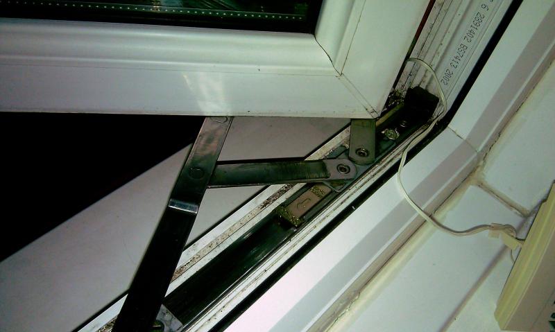

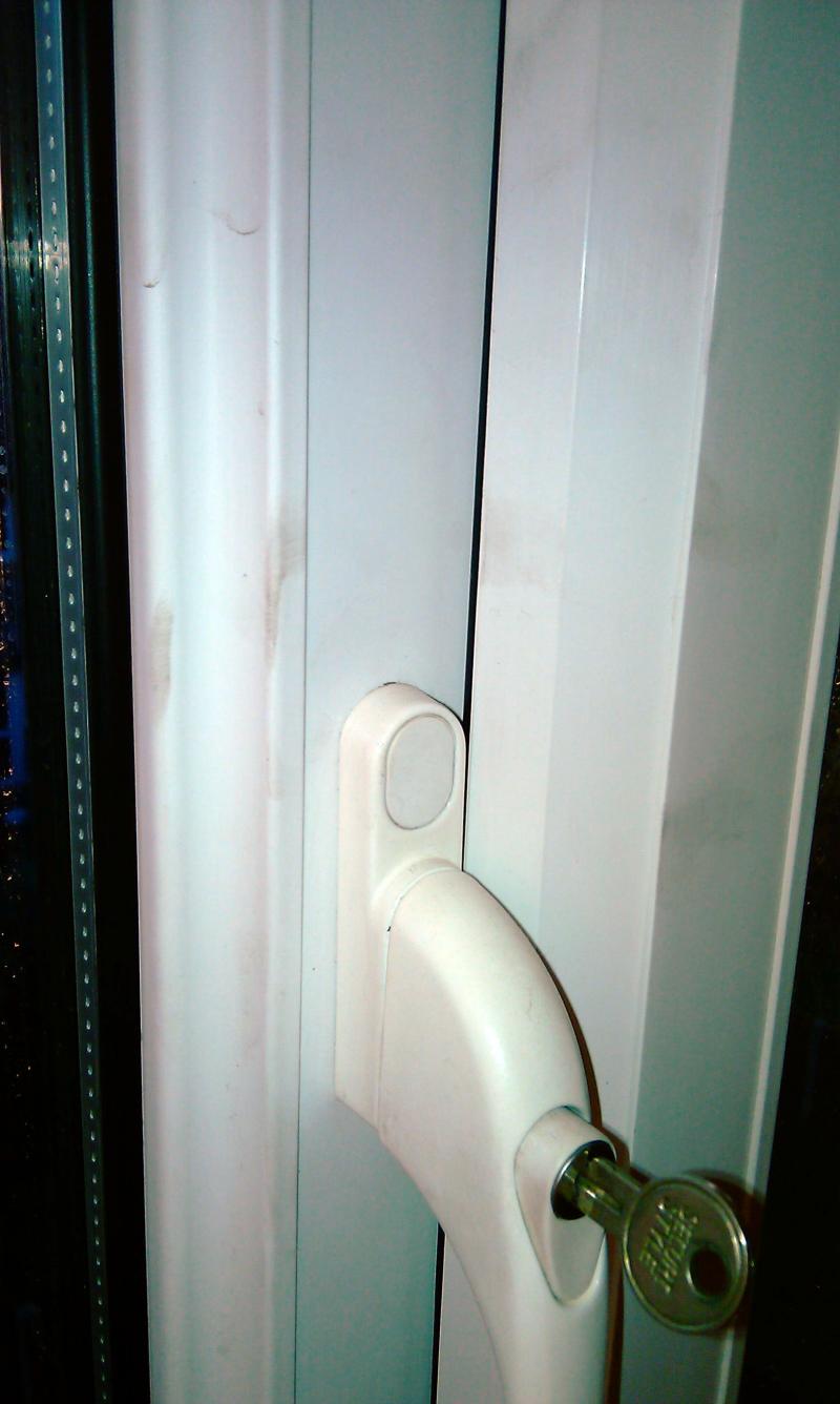

Apologies, I don't mean to hijack the post but I think I'm also having the same issue here. I have just completed on a flat and found that one of the windows is having a similar problem except mine seems to be the whole of the back of the window rather than a corner. Please look at the attached pictures and advise if there is a fix for this?
I've managed to get it to close better by literally hanging out the window and punching the back in which i don't intend on doing again as my flat is on the second floor.
Many thanks in advance,

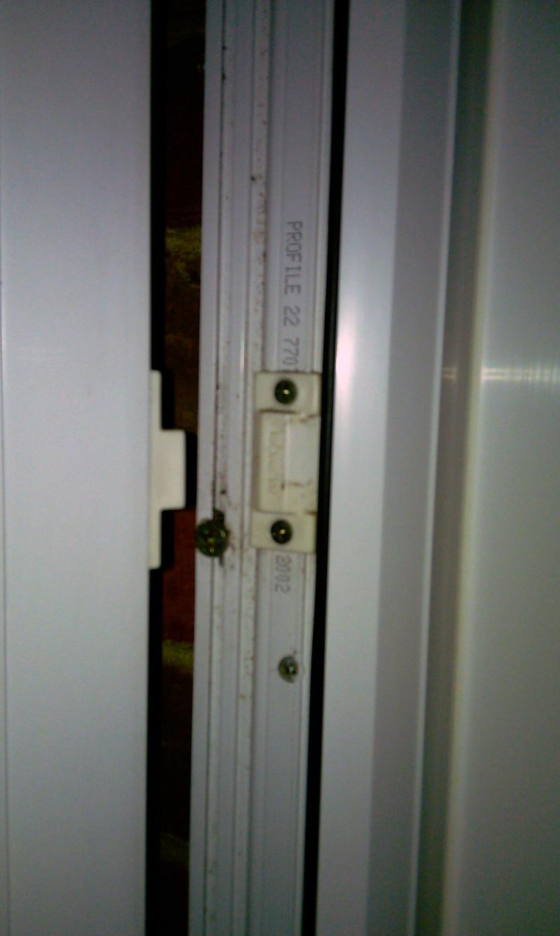

can you post a few pics of the window open showing both the handle side of the frame(not the opening bit but the blocks that the window sits in and also the hinge/runners when the window is open
reason i ask is different profiles use different locators and mushrooms or push bolts etc to secure
it could be as simple as a quick adjustment but so many different profiles out there its hard to advise without seeing what you have
also look real close around the inside of the window opening and look for printed text which will tell us the profile of the frame
ie rehau, profile 22 etc

Hi easyt,
Many thanks for your help. I have uploaded more pics showing the hinges as requested. The profile on the frame is:
Profile 22 7707 6 2891402 BS7413 2002
I hope this means it's possible to fix this issue.
If the gap is on the hinge side the top hinge is most likely worn and you will need to replace the hinges.
As Browney says its the hinge not locating properly, change it like for like, looks like a easy clean egress type of hinge, might as well get a pair and replace both.
The problem is the lug at the end of the hinge part thats attached to the opener is not locating in its keep which looks plastic and once its cut a groove it will always take the easier route outside of the keep.

I don't suppose anyone could tell me the name of the plastic ramp/wedge type thing in the middle of the frame on image number 5 posted by thecrater?
One of my windows is closing snugly at top and bottom where the hinges are but in the middle where this little plastic ramp is there is a gap - it's as if the plastic is a little worn but I don't know its name to get a new one

In both cases its your friction stays ie hinges that have failed/worn out.
I notice somebody said change one,unless you can find the exact same hing you should ALWAYS change both as the opening arc is different from one hinge manafacturer to the next and if you mix them you will find the window opens unevenly or even binds in the open position.
The repair involves removing the opener to replace the hinges which come in two stack hieghts and as standard/ restricted/easy clean/egress.
My advice....get a local repair man in.
Cheers
They dont normally ware out what tends to happen is the wedge on the opener closes the wrong side of the frame receiver and pushes the window away,to check this take one side off and see if it closes then.
Or as its a dry fit sometimes its a heavy ressistance and doesnt sit fully,try oiling them.
If you cant find what you need pinch one of a window that closes properly without one.
