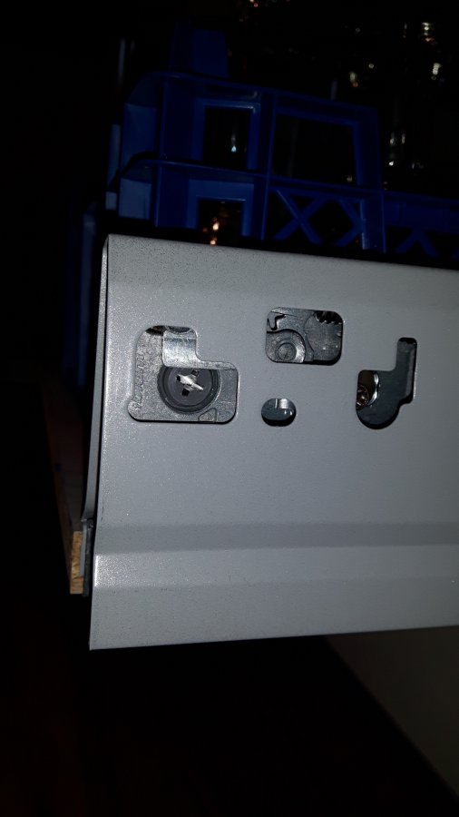

Hi.

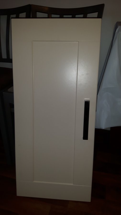

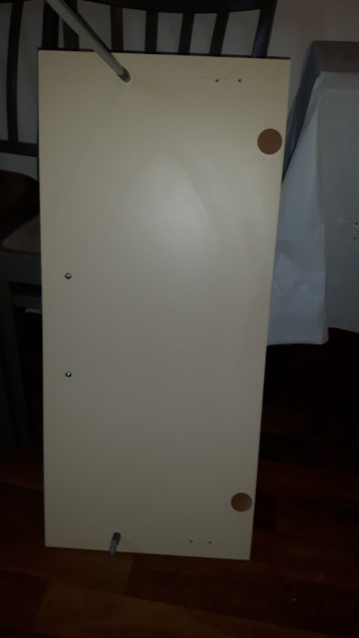

The drawer front on my kitchen units has come off. Also the front fixing that holds it to the unit has broken off too. I can't figure out how to release the front fixing.

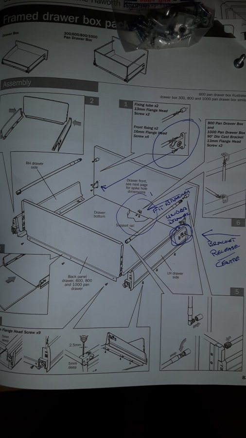

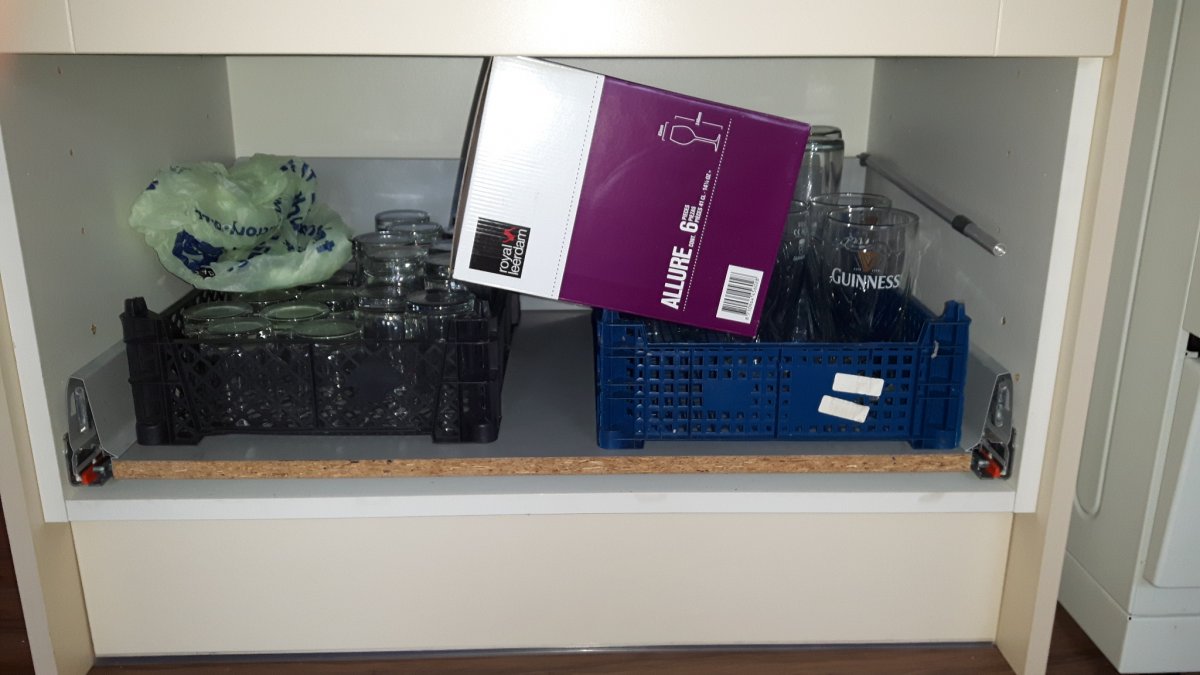

some images of the drawer itself - rear view of the front & also where it fits onto the drawer unit alongside each other would be useful & perhaps one of a drawer which is already fitted

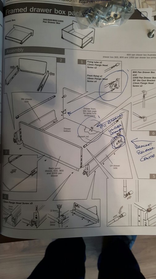

Looks like a screwed down on the front is then tightened from the side to secure & pull it all tight & together....
I think they snap into place , the screw slots are to adjust the draw front levels.

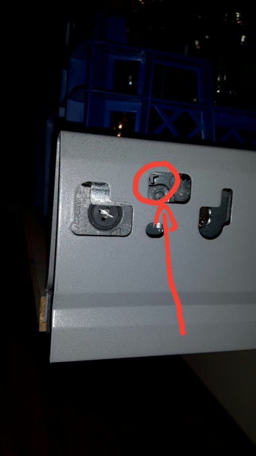

I finally figured out how to release the fittings. There is a PhilIps shaped gap located inside the middle rectangle hole.
I couldn't see it at first as the mechanism was hidden. I used the screws which allow for height adjustment and there it was.
A quick turn with a screwdriver and it popped out. Put it all back together and secured it better and the job is done.
