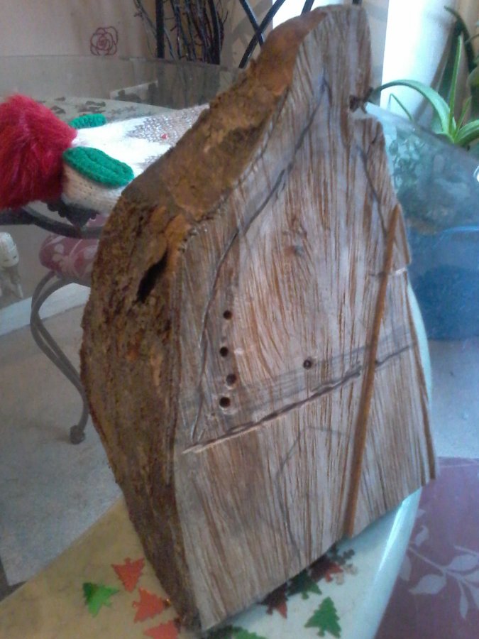

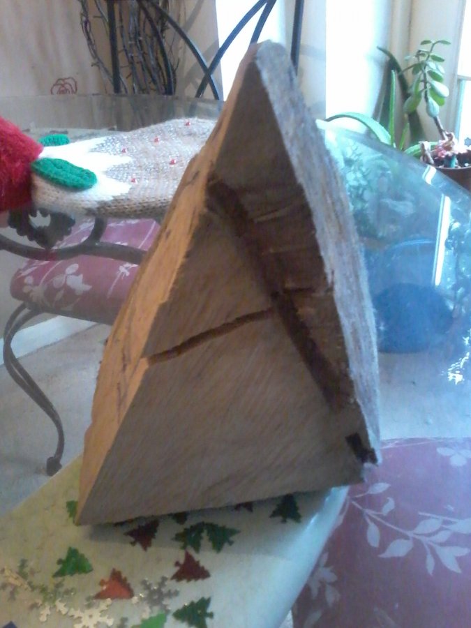

Hi all
I have large blocks of really hard wood that I want to make big holes in.
Basically I want to make fairy houses and need to get rid of big amounts of wood to make rooms.
I have brought a Challenge 710 wat hammer drill and a good set of drill bits. I have also brought a set of wood chisel and a mallet.
I did have a little bit of a bang around with the chisels but to be honest, there is no way they are going to make any dent in this wood.
I have been looking at hole saws which are attached to the drill but unsure if this drill make them and wondered if they are universal or not or do they have to be for that particular model of drill.
Just don't want to waste any more money on tools that are not up to the job and would welcome any advice from anyone that knows what they are doing please.
Many thanks

Maybe a small chainsaw followed by chisels and then lots of sanding both by hand and using round drill sanding bits - never done it myself and I am no expert. Just thinking out loud as to how I might approach it!
I think I'd consider chain drilling to a set depth with some flat bit drills, and then chiselling the waste away. No hammer action wanted for that!
John :)
Thanks for that John. yes i had thought that maybe drilling and chiselling as you suggest but wasnt sure. The chain saw looks fun though and definitley looks the quickest way to get the job done. But want to have an upstairs and downstairs with some kind of roof. I know it will have to have an opening so I can put things inside, maybe have a removable roof.
Gosh I didn't think it would be so difficult. What I really need is the inside hollow but with a ceiling and stairs inside. The ceiling doesn't need to cover the whole area as the stairs will need hole.

A sculpting chainsaw is very expensive, and equally dangerous :eek: and the chain bar is pointed so the timber can be attacked point on. Not a tool for the inexperienced!
Flat wood bits range from 6mm up to 35mm or thereabouts, and if the timber can be clamped down, are quite effective. Easy to sharpen too!
John :)
You do need to have protective clothing when using a chain saw, even a small one can cause serious injury before you know it.
Those battery saws are quite good for what they are, but if dealing with hardwoods the battery life is severely limited. However, they are easy enough to sharpen (every 1/2 hour or so). The work piece must be clamped down!
Again, I can't stress the safety issues too much!
John :)
