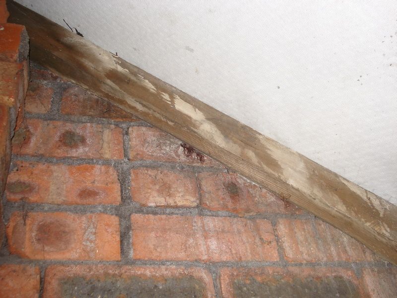

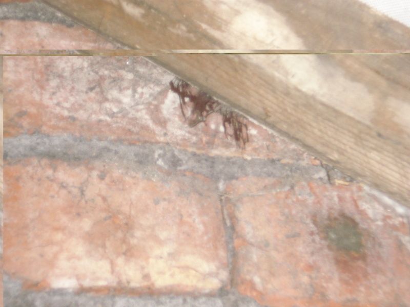

This weird dark brown stuff has just appeared on one of my rafters near the top of my roof by my chimney breast. I've had unfortunate luck with roofers and since 2012 it's leaked here, in fact I think it's been leaking (on occaision) in this place since before I bought the house 9 years ago. It only gets wet in the worst of weathers though.
Do you know what it is and do you know how to fix it?
It's too high up for me to get near BTW.
What you show is suspicious but until someone actually examines the "dark brown stuff" & confirms that its organic, the roots of a plant like vegetation, then its not possible to say what it is.
Try for a roofer who will go up on the roof and take pics of the area around the chimney stack - and hopefully they (or someone else) will climb some steps in the loft to examine and probe the rafter in the pics.
Why dont you take pics from ground level of the gable peak (presuming you have a gable) at the chimney stack? And pics in the loft showing the whole upper chimney breast?
Post all pics on here.
You appear to have an unusual construction detail with the top of the rafter actually going into the chimney breast brickwork - this is a bad practice.
Are the flues in the c/breast still in use or redundant?
Whatever it is or any other faults we can suggest how to fix them.

The "brown stuff" could be wet rot tendrils - not great but better than dry rot. Whatever it is the sound method of dealing with it would be to replace the rafter.
