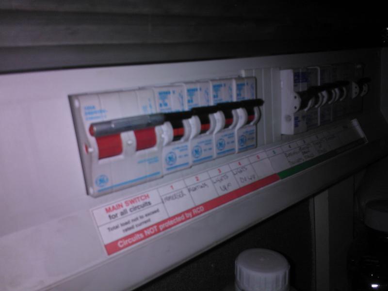

I would like to install a 1 or 2Kw electric fan heater into my bathroom which is through the wall of the cupboard where the hot water tank is.
Would I be able to connect the fan heater cable (Live and neutral) to the Feed/mains part of the double pole switch?
My thoughts are, the double pole switch would not need to be switched on in order for the fan heater to work as it would be connected directly to the mains part of the switch and not the LOAD(where the immersion heater is connected). The double pole switch would have to be on in order for immersion heater to operate (as before).
This would essentially adding a parallel circuit allowing both the immersion heater and the fan heater to operate at the correct 230V.
Feasible?

Possibly.
It is likely that your immersion heater is drawing around 3kw when energised. Add this to your proposed 2kw fan heater gives you potentially 5kw - around 21A.
Your immersion heater circuit is probably wired in 2.5mm² T&E which is okay but your MCB is probably rated at 16A.
Increasing the MCB to 20A would be feasible but you will still be under the potential 21A.
Increasing the MCB to 25A would be feasible but you will start to get close to the current carrying capacity of the cable.
You could raise the MCB to 20A and use a 1kw fire - just make sure that you follow the manufacturers instructions which will probably stipulate that you must put the fire on a fused connection unit rated at 13A.
I like the idea of increasing the 16A 'thingy' to a 20A or 25A.
It's the red number one 'thingy', the one that reads "immerser". It says B16 on it. I presume that means it is 16A. Also the red writing below says "circuits not protected by RCD", whatever that means.
How would I replace the B16 with a B20 or B25?
No RCD - easily solved by fitting one of these:
http://www.toolstation.com/shop/d190/sd2470/p45636
in the cupboard and connecting the heater to it.
By switching off, removing the cover, removing the wiring from the B16, unscrewing it, unclipping it from the busbar, and reverse that process to fit the new one.
However note that the main incoming wires for the consumer unit will still be live even with the main switch off, and that particular brand of CU is no longer made, so may be difficult to find parts for it.
Unless it is likely the immersion and new heater will be used for extended periods at the same time, leave it as it is.

Fan heater instructions will probably require the use of 13A fused connection unit.
As some of your circuits are not RCD protected you may have to upgrade equipotential bonding in the bathroom to comply with current regulations.
If the immersion heater is only used for back-up i.e. you have a boiler for the heating and hot water, then you could fit a changeover switch so that the fan heater and the immersion can't be used simultaneously.

just to clarify, do I need to fit an RCD or 13A fuse?
Or can I just connect the electric heater to the double pole switch?
In bathroom fit an RCD or RCBO in consumer unit.
FCU or local isolator should be outside of bathroom.
Fan Heater must not be fitted in zone 1
