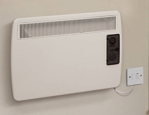

Why do I need to hard wire a new 2kw panel heater In.yet have a 2kw conveter heater with a plug on confusing
It's quite simple really, and nothing to do with the kW rating. A panel radiator is a 'fixed appliance' and is permanently wired in. Like this:

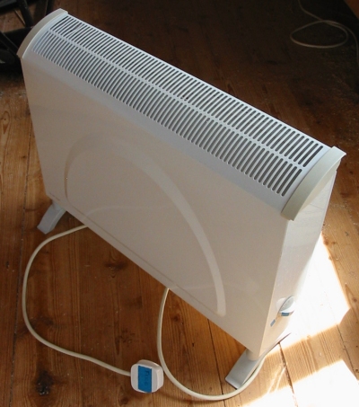

By 'conveter heater' I assume you mean a convector heater which is a 'portable appliance'. It is free standing and not fixed to anything, so can be moved around, and plugged in, as and where required.

It needs a fuse. You want a "fused connection unit", or "FCU", like the one pictured above. With a 13A fuse.
As well as the fuse, these things have a proper outlet for the flex (if you buy the right one!) with a cord grip.

A 2kW fixed heater should be hard wired in via a Fused Connection Unit (FCU) The instructions that came with the panel heater should tell you this. You don't state what model your heater is, but as an example, the installation instructions for Dimplex panel heaters state:
"The heater is fitted with a length of flexible cable, for connection to the fixed wiring of the premises through a suitable connection box positioned adjacent to the heater."
For this reason they are not supplied with a plug fitted. The first photo I posted shows you how it should be done.
Portable Appliances on the other hand come with a plug and correctly sized fuse already fitted.

Portable appliances must have a plug fitted.
Fixed ones do not, so they are not supplied with one because it reduces costs for the manufacturer.
