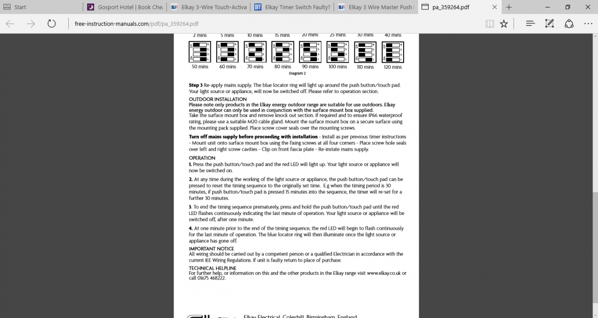

If I have read the instructors right about operation, it says the switch should light up red when the appliance (element) is switched on. But mine goes off.
There is a blue light on when the appliance is off and when you touch the plate, the light goes off (the element works fine) and only flashes red in the last 1 minute of use before switching off and going back to a blue ring.
Just wondering has anyone fitted these before?

Number 1 under Operation states (if I have read it correctly) the red LED will light up. It doesn't say that it stays on or goes off but I would have thought it should stay on. I don't even think it flashes red, the blue light just goes off.

Reading your instructions it seems maybe the red light is on all the time the load is on.

The last line in the instructions may be the best way forward

Just managed to get hold of the technical support. Really friendly actually. The switch works as advertised. All lights are extinguished when the appliance is switched on. My bad!!!
