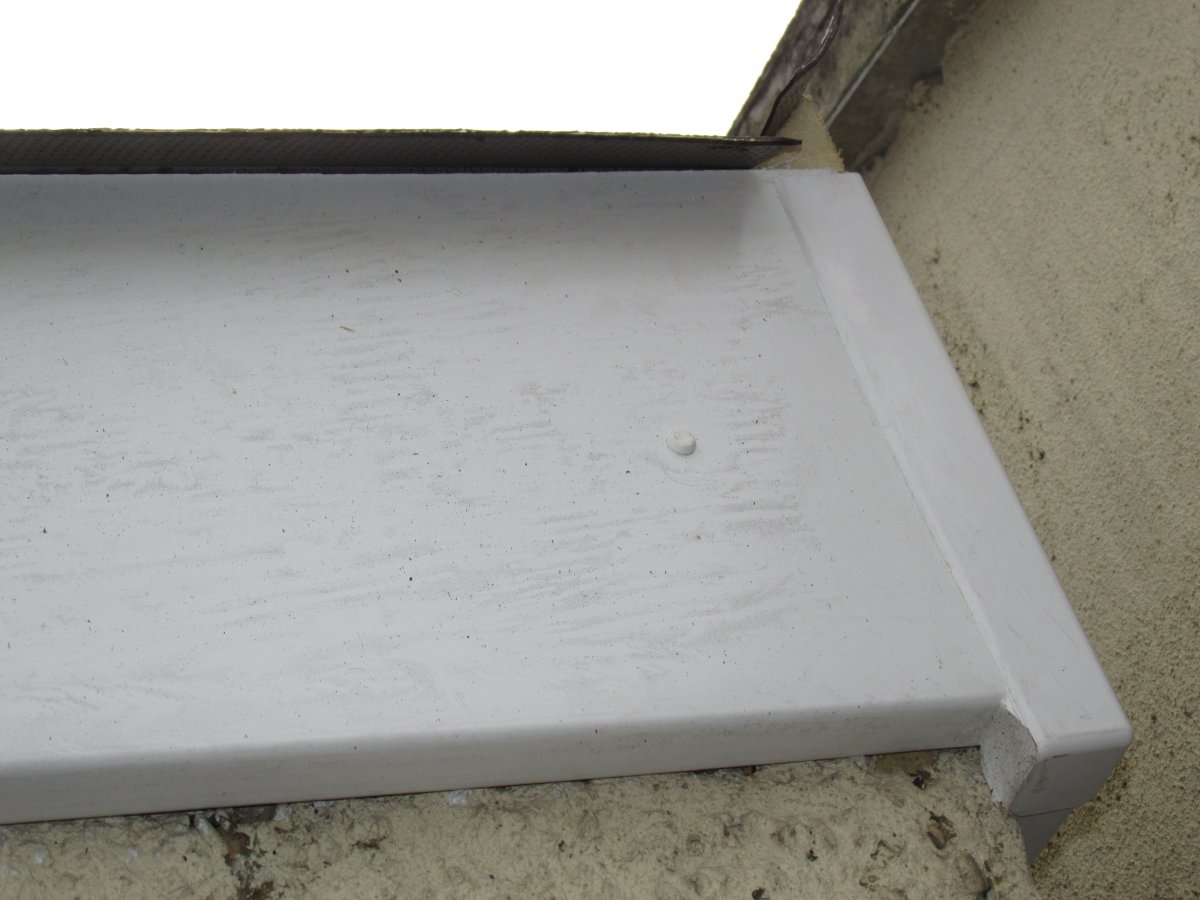

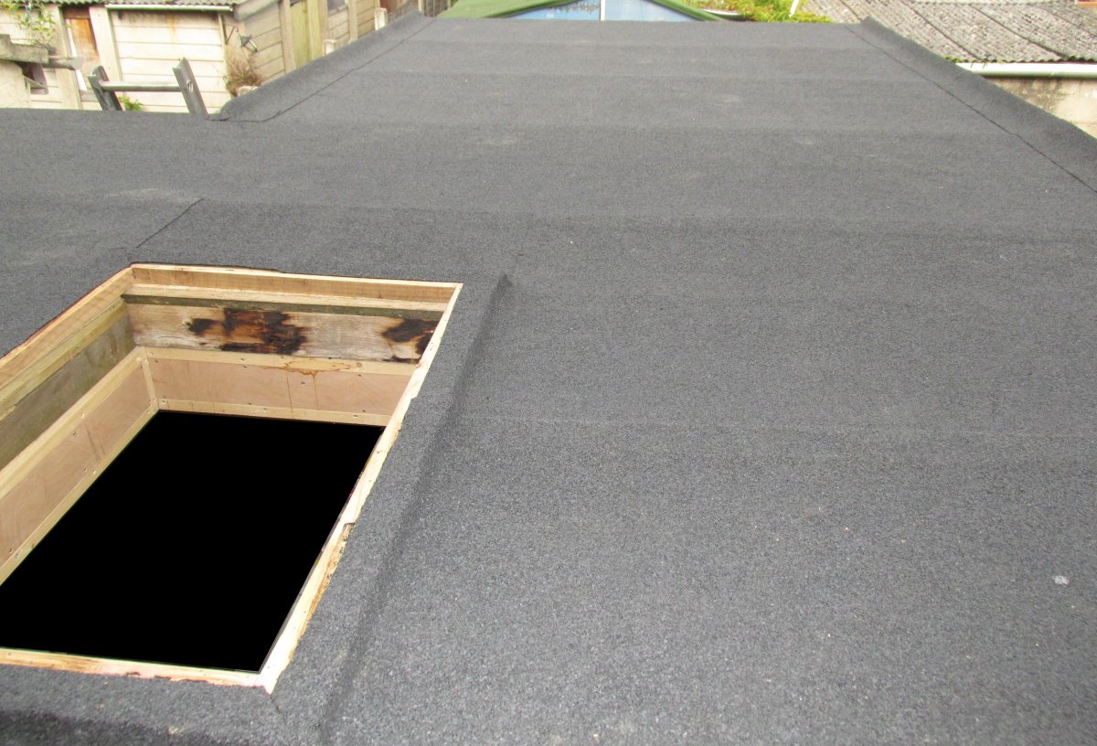

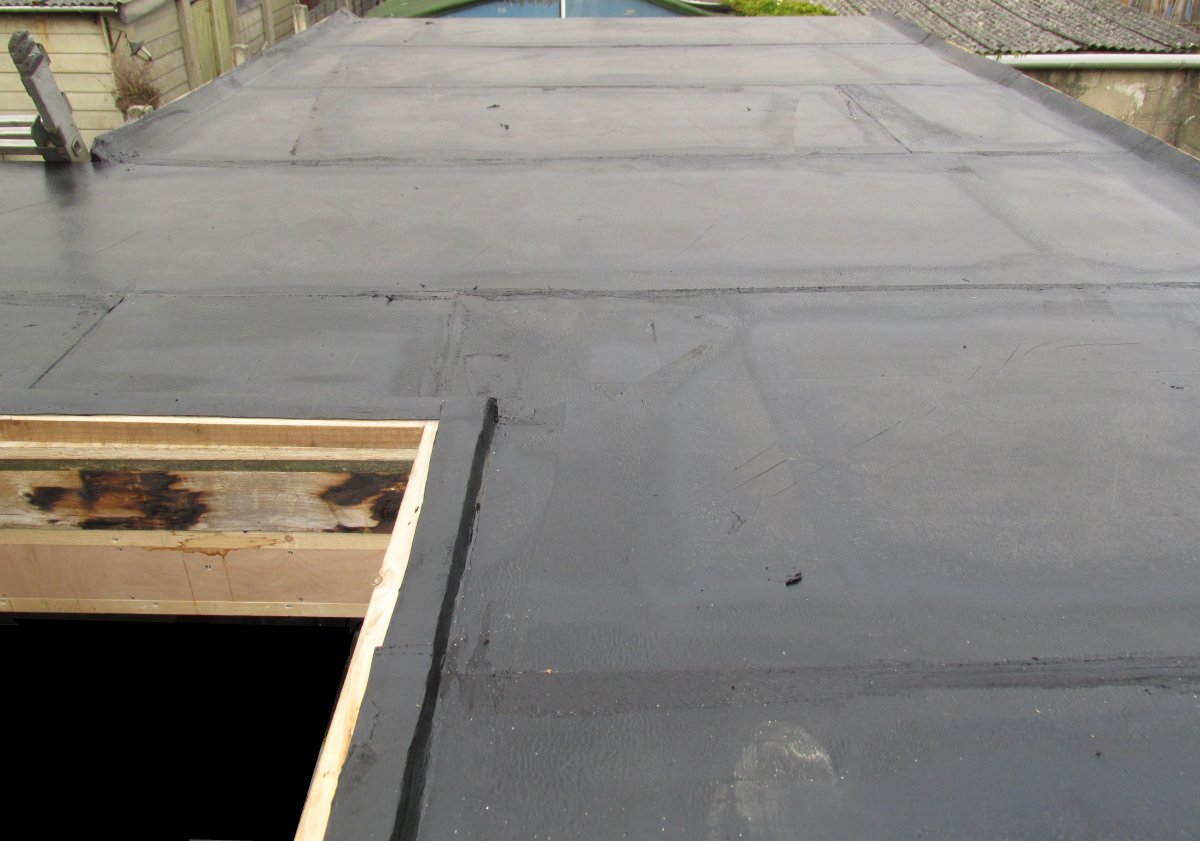

Do you have photos - esp. at the chimney stack and fascia areas?
Is it a warm roof or a cold roof?
My New Roof was done in a day and a half in the end! First day 10am to 6pm, second day 9am to 11am.
Is it a cold roof.
Have enclosed some photos.......... and would give the roof a 6/10!

yep you have a cold roof and as such should really be ventilated to the outside over your insulation.
100mm celotex between and 50mm under the rafters would be close to regs or200mm between. though what you are proposing would almost certainly be an improvement on the existing.
If there is no ventilation, then introducing some might be difficult now your roof is finished and if this is the case then I would definitely include a VCL
