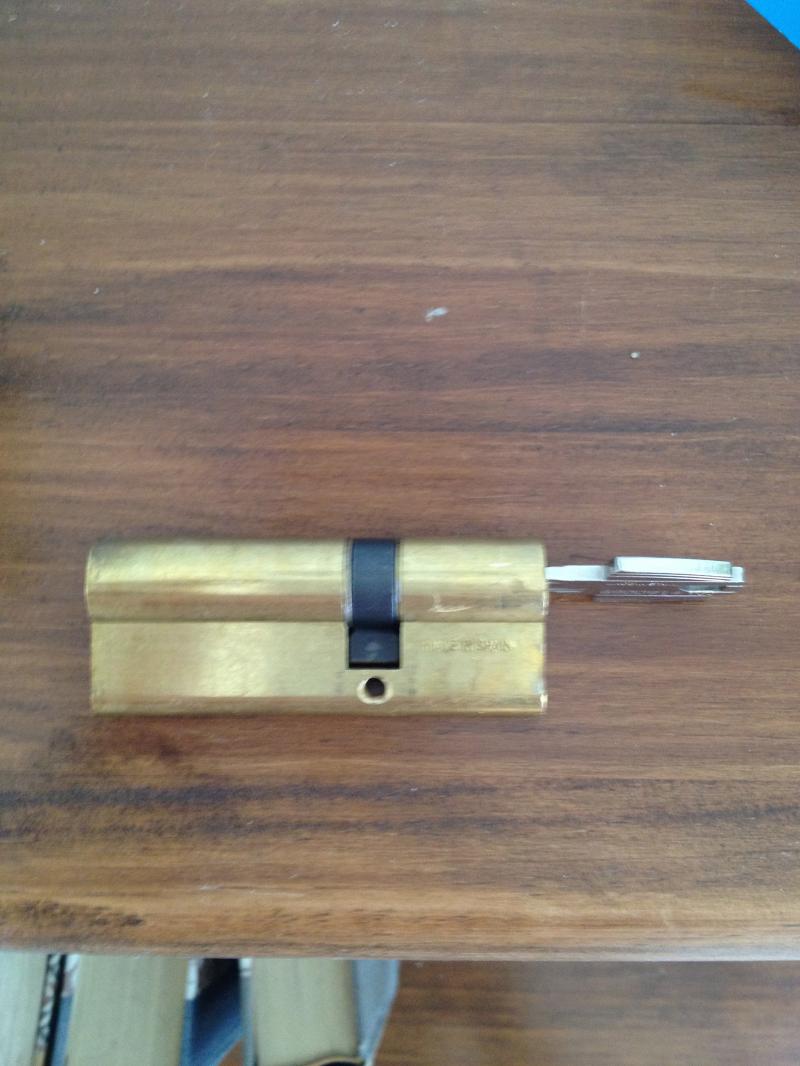

Hi guys,
I am replacing my euro cylinder locks and the front door lock measures
25/ 45 (internal/ external).
However I can't find any locks that small. The closest is 35/45.
Would this fit, albeit stick out 5mm on the inside?
Here's a picture if it helps:
Inside is not the critical size as long as the external part is flush or protected from attack that is the important.
If you can not find the size you need you are looking in the wrong places.
Go to your local locksmith shop. They will either stock the size you want or be able to order it for you.
Best advice get one to British Standard EN 1303:2005
The Yale version is available from 25-10-25 up to 55-10-40 the first number being the anti snape side.
