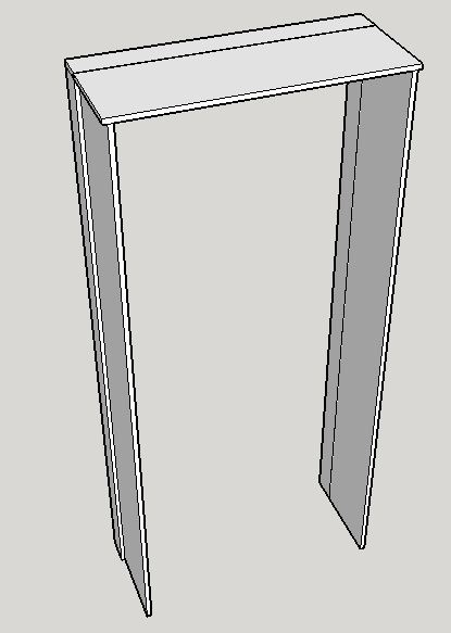

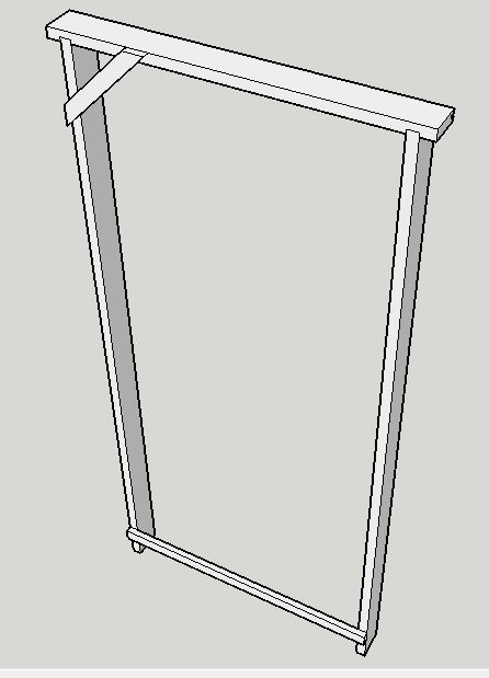

Don't even attempt to build-up a plywood or MR-MDF lining that deep and hang a door directly off it - you will never make it work. The way deep liners are made is to build a frame or door casing with a rebated or grooved edge to carry extension pieces and fit that first.
Because there is very little to support your door lining I'd suggest that you make-up plain door linings without worked rebates but using housed joints. The housings are worked using a router and a home-made jig. The linings are glued and screwed together (note the horns - these are essential to assemble any door lining or casing):

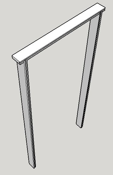

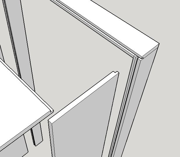

One edge of the components (jambs and heads) must also be grooved (say 9mm wide x 12mm deep) with a router:

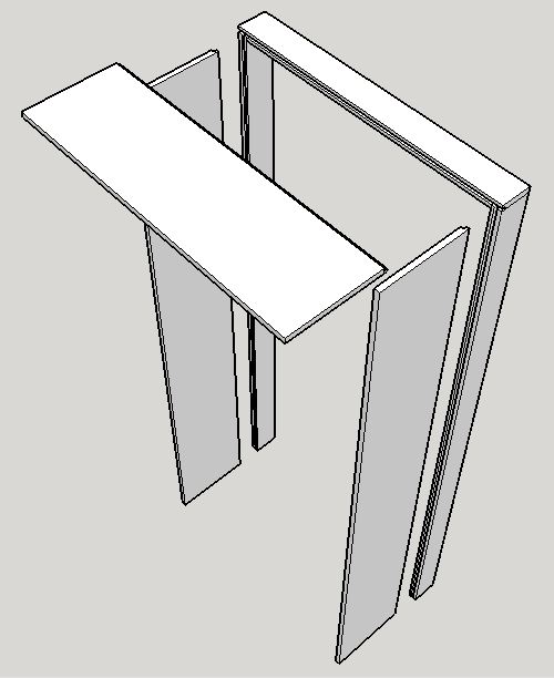

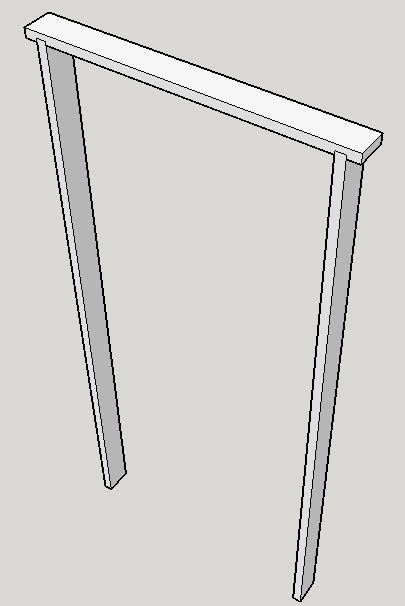

Make sure that you brace across the top corners of the linings to keep the heads square as well as bracing across the lower parts of the legs, say 100mm up from the bottom) to the jambs and the legs the same distance apart:
The bracings are something like 2x1 softwood battens and are pinned into place making sure that the pin holes will hidden by the architraves when they are fitted (so generally not within 10mm of the inside edges). The horns are sawn off just before installation (they add to stiffness whilst moving the lining to where it will be used), but the bracings are not removed until the lining has been fixed in place and foamed-in. Use a 6ft level to plumb-up the jambs and to ensure that they are not bowed and a 2ft level to level he head. You may well need to build-out from the existing wall with 3 x 2 or 2 x 2 softwood framing to get a fix into (using drilled and countersunk holes - these can be filled with glued pellets afterwards).

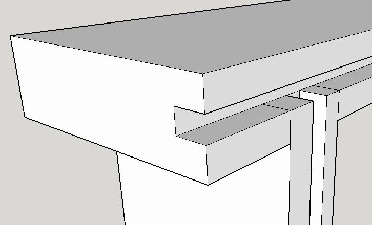

Once the foam has set the bracings can be removed. The linings are then built-out with rebate edged MR-MDF or plywood panels:

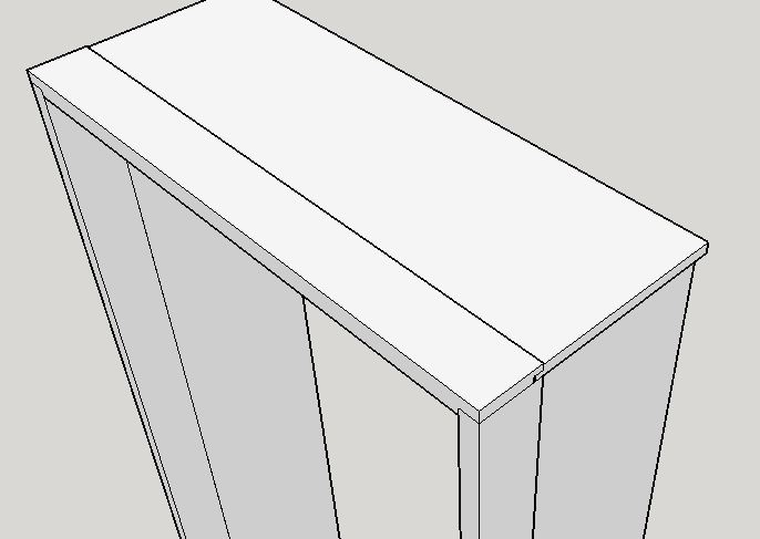

The rebated edge of the lining panels should be a couple of millimetres shorter than he depth of the grooves to ensure that you get a tight fit. You will need to cramp and glue these liners in place (a couple of 2 x 1 softwood clamps will do for each one)
The door lining will need to have door stops attached to it after the door has been hung. The liners can be made with recessed panels if you prefer that look

There is an easier way. Make yourself a two non-rebated casings to start with using regular pine, like jobandknock's first image. Fit one at each 'end' of the doorway opening. Hang the door off whichever one you want.
Finally, add planted door stops made from 10mm MDF. Fix the MDF the full width across your two linings and you will have fully lined the whole of the doorway. (Sand the edges to prent furring up, as you described. Squirt some expanding foam behind the MDF if you want to avoid a hollow sound when knocking on it whist saying "ooh what a nice old deep door lining".)
