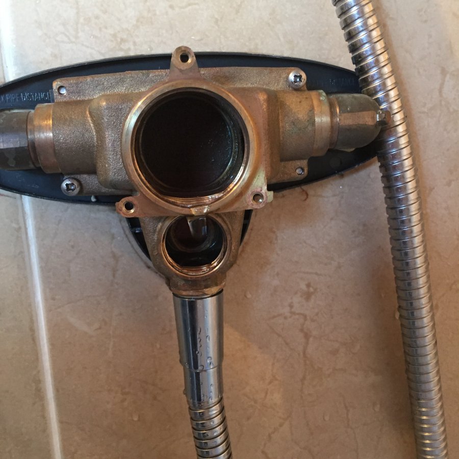

If nothing else has been done then you have a restriction that has built up in that shower circuit somewhere then. Either in the pipework, body, shower hose or head. Need to work your way back ... 2nd 2 are easy to test for, disconnect hose from the shower body and see if the pump kicks in. If not then you're into the shower and the on/off valve needs looked at. Still no joy then out with the valve and run the supply pipework alone.

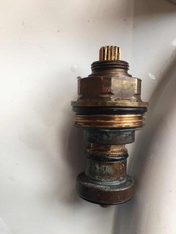

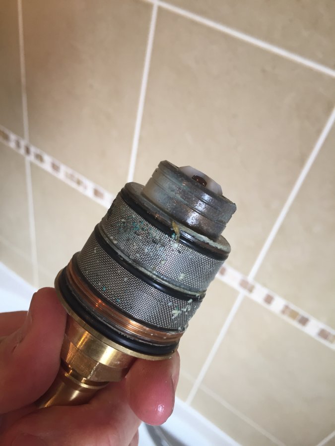

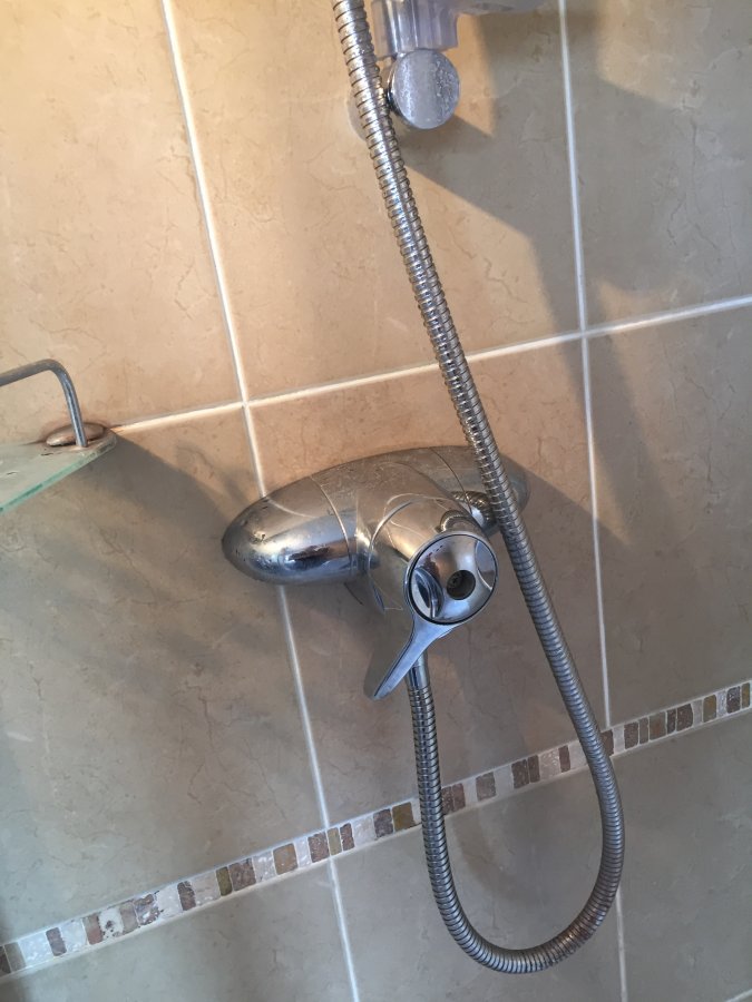

Ok, I've swapped all possible parts from the identical shower in the other bathroom (the one that works fine) including the cartridge and the thing that turns the shower on and off. (See photos) Swapped the shower hose and head from the other shower, still same problem.
The parts from this shower I have put into the working shower and that is still working fine.looks like these parts on not the issue.
If I take the hose off it works. But neither shower hose works.
Just for info. It occacially works when you turn it to just cold. But then the next time you try it it doesn't work. This is not an issue with the working shower.

Found a temp. solution. If I drop the shower head below the shower unit it works fine, starts up ok then hook it back up on the sliding bracket.
Remove the non return valves there is not enough head height to open them and they are not required on balanced pumped supplies.
They should have been removed when the shower was installed.
