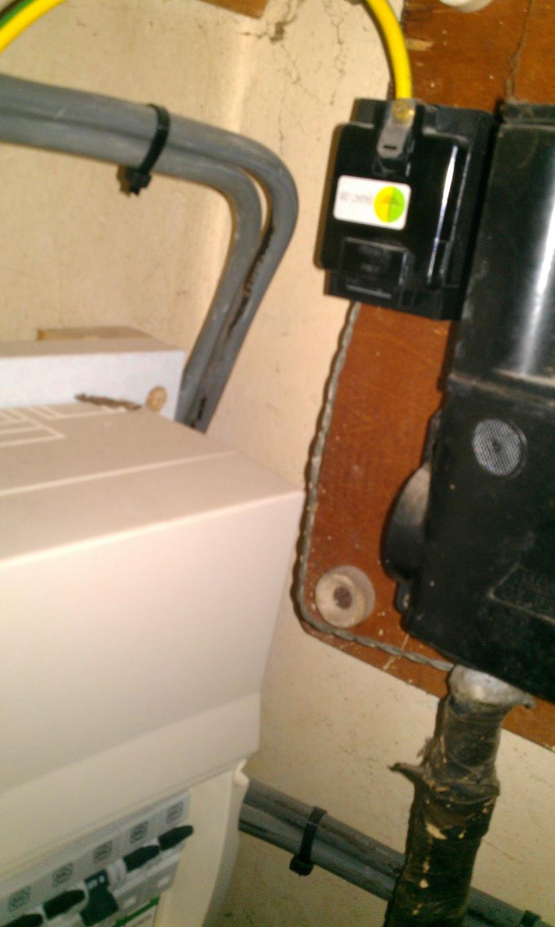

Does that mean my earth is supplied via the black cable? The black cable is the feed to the biuse, the black box to the right then has two meter trails running to the electricity meter, then in to my CU
The only pipes or anything going in to the garage is one blue plastic water pipe that is under the concrete floor
Cannot see quite from your photo.
I guess the earth cable goes into the black box, and that the twisted conductor comes out of the box and then connects to the metal outside sheath of the incoming cable?
If so, you probably have a TN-S supply. But needs closer inspection, really.

I will get some better pictures of the earthing soon
