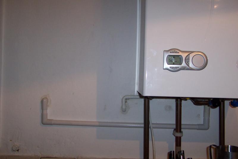

Having recently had a Ferroli installed, understand that was a mistake to start with. I am having problems with Ferroli's guarantee. Some of the issues my installer has rectified. However the installer is arguing with the following. Ferroli say there must be a pipe connected to the domestic side of the boiler or the heat exhaustion will eventually melt. My installer says this was not necessary but in order for me to get cover will connect pipe top my HW tap. This will be at an additional cost to myself of £200.
I believe this domestic pipe should have been done at the time. As a lay person with no clue about boilers is the installer in the right or is Ferroli just trying to wriggle out of cover. Having looked at the diagrams on my instructions I can see a pipe connected to HW tap.
If the installer tries to charge me how to I stand my ground?
If you saw how the condensate pipe was installed from one of my previous posts I think you would see what I am dealing with.

Looks like he has used a combi as a system boiler so therefore the domestic hot water is not connected to anything.
Tbh though not surprised at the quality or lack thereof as this is the type of installer ferroli seem to attract with their ****boxes.
Going by that pic I doubt the system has been flushed properly which if it hasn't this boiler will most likely end up costing you more in the long run.

Its a DOMIcondens HE 26 C. Page 3 of the instructions has an image where it shows piping direct from boiler to HW tap. If I am unable to get the installer to complete the installation to Ferroli's standards without trying to charge me is there an outside body I can complain to?
