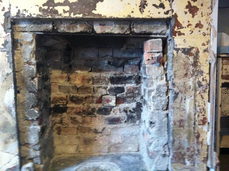

Hi all, newbie here, first time reinstating a fireplace, finding lots of useful help and pictures on forums, just need some clarification before continuing much further......
I've got as far as can be seen in the pictures, just wondering how much further I should go with this before the house falls down!

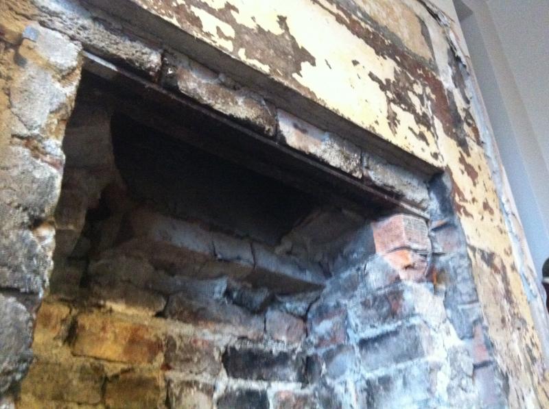

I'm thinking it would be OK to remove the final rough layer of bricks to reveal the builder's opening, but what's stopping me from going ahead is the question of the lintel.
There are two thin metal bars that sit on the top of the rough bricks I want to remove. They seem to be supporting a fair bit above them as there is quite a distance until the brick arch.
Should I put in a second lintel to be absolutely sure all will be OK, or should I remove the rough bricks and replace them with a layer of new bricks thereby keeping the metal bars in place. The opening would be big enough if I did this.
I haven't yet decided 100% between a stove or an open fire, wanted to see exactly what I was dealing with first.
Also, looking up inside the fireplace, if I was to remove the final layer of bricks it looks as if a lot of the throat would come tumbling down too, is this wise as it helps the smoke to rise quicker doesn't it? Obviously not an issue if going the stove route, but might need rebuilding for an open fire?

Why not post a pic showing the outline you want for an open fire? Get dimensions for a stove opening from Mfr's specs.
The throating in the pic is not the original throating - i suspect that the original throating might still be in place at the arch height.
Typically, you would be best advised to remove all up to the arch. You could then build up, or whatever, to suit your requirements.
One thing, is that area above the metal lintels a panel of brick or is it a concrete lintel?

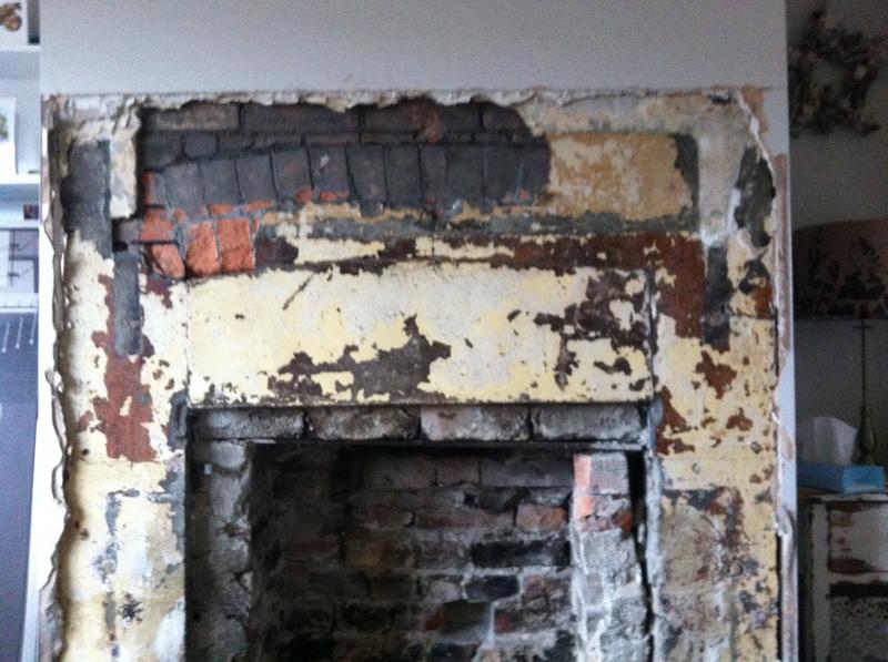

There is a slab of concrete that sits above the row of bricks that sits on the metal mini-lintel. It is a huge slab and sits directly underneath the brick arch.
The brick arch doesn't seem to be in very good condition, the plaster has eaten into it quite badly. So having it as a feature isn't going to be an option and it will need to be plastered over again.
Knock off some more plaster at the bearing ends of the concrete lintel and post close up pics on here. Its difficult to tell what the concrete lintel is bearing on at the moment.
Why such a monster lintel was installed is a mystery unless it just happened to be handy?
The brick arch is fine and in great condition - there's no sign of slippage and the centre key brick is firmly in place.
Removing all up to the arch, and maybe then adjusting the brickwork (& metal lintels) is no big deal.

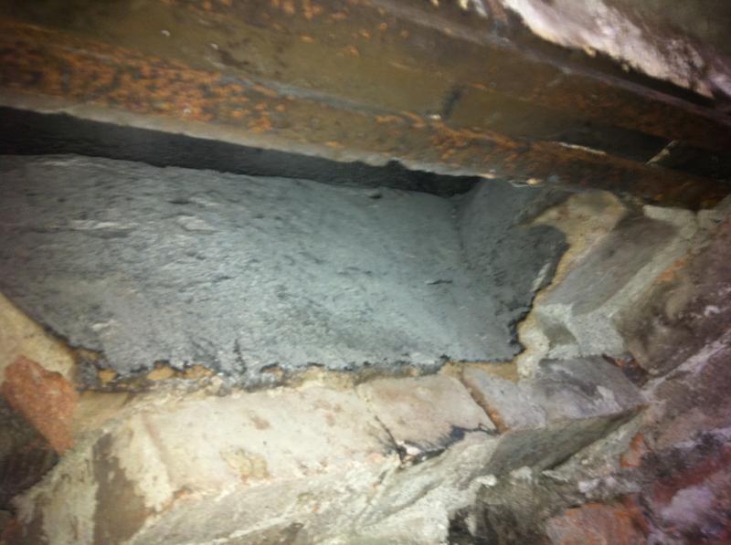

Ree, I will chip away from the edge of the lintel and see what's there, won't be for a few days now, like you say it is bloody huge which is what made me think the arch must be knackered otherwise why put it in there in the first place?
OK, I've chipped away a bit more, not too much as have the neighbours to consider, but, I can see that the lintel is not resting on anything. I can get my trowel behind it and down the sides, it's just under 1.5" thick, will make a hell of a noise when it comes out!!! There's more bricks behind it.
it's all starting to make sense now, I can see the original throat behind the arch, all looks good. If I remove everything below the original throat and arch until I have got the original builders opening, I will be left with a space 18" deep, 37" wide and 50" tall in the middle.

Looking at the concrete lintel under the arch, I am wondering if it is actually a template they used to build the arch, because it fits perfectly underneath each brick of the arch. Also, as it isn't bearing any real load then it's not really acting as a lintel so must have had some other purpose?
