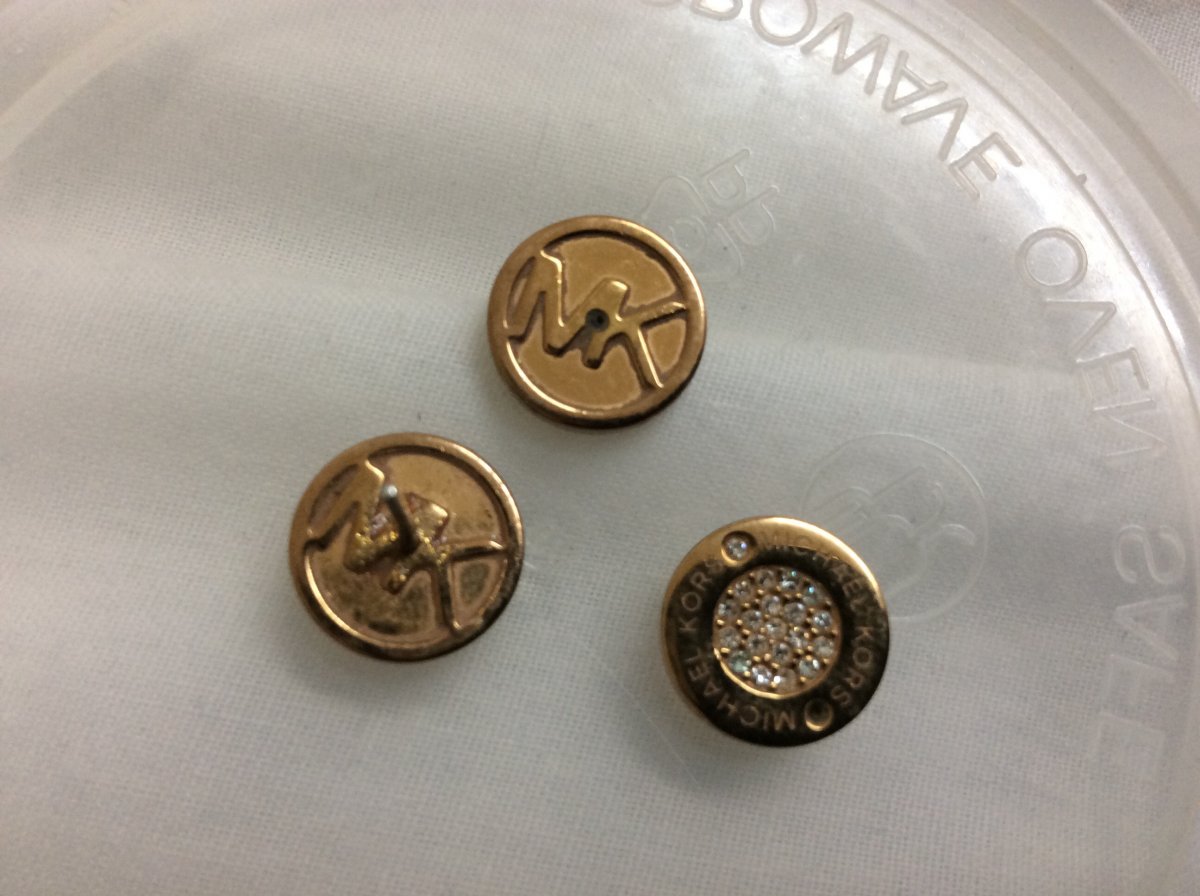

Hi all
Wondering if anybody could give any advice
Missus earrings broke and I asked local jewellery shops of they could solder earring pins for me on the two broken ones and they said no we only deal with gold this is cheap stuff lol
Now wondering what alternative there is as I wrongly assumed this would be easy to fix
Any advice much appreciated as it's a sentimental gift

Awkward as hell, but not to a silversmith that could be bothered.....
For pins, consider PCB pins suitable for an electronic breadboard called Veroboard.....about the same diameter and ready tinned for soldering. The trouble is, they come in boxes of 100 or so, but they are cheap enough.
Where the pin goes, is there a hole right through?

No hole through
Very tiny hole very!
Is there a type of shop / workman I can approach as I'm not comfortable doing myself....

What exactly are the skills may I ask? Is it soldering basically?
Yes, but if I remember my old soldering skills, you'd use silver solder rather than the ordinary stuff, but JJs suggestions a good one.

When repairing jewellery and other soldered items, you ought to use a solder with a lower melting temperature than was used for the parts you are repairing, or they may dismantle themselves.
