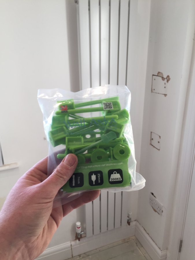

Fixing large double rad to thermolite block wall.
Or try the wallAnka's like I suggested above :rolleyes:
Here ya go... I have some left over ;)
Have a search for Dryline pro, they are designed for this type of job and work really well. I used them a lot in my previous house with thermalise block and dot and dab walls.
