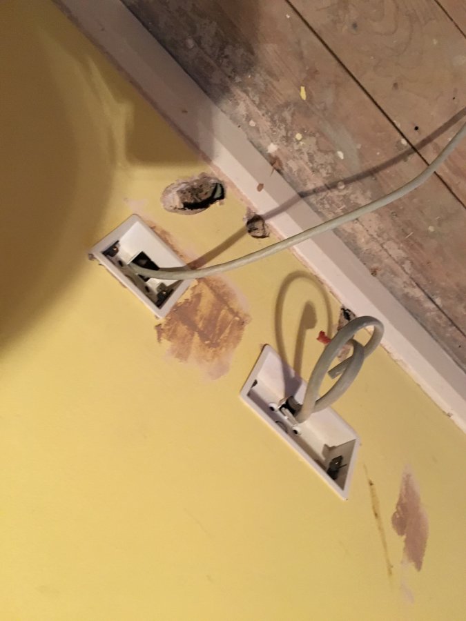

What's the best way to fix the following small holes in plasterboard
No best way , just lots of options, depends what you have available and how large the hole.?
1.If hollow behind I squirt in a little expanding foam, trim when set and filler to finish.
2.Glue in a small piece of card or timber or plasterboard across the rear and back fill.
3.Push in a piece or repair mesh and fill.
Many more options.
