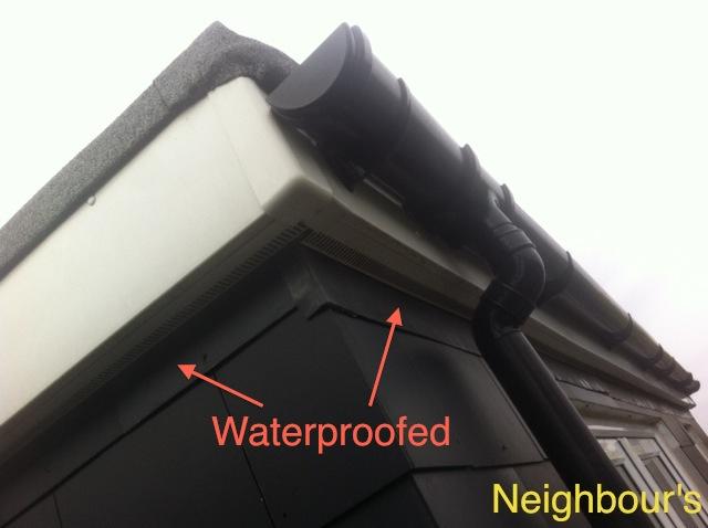

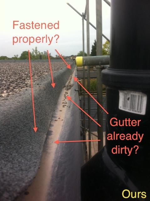

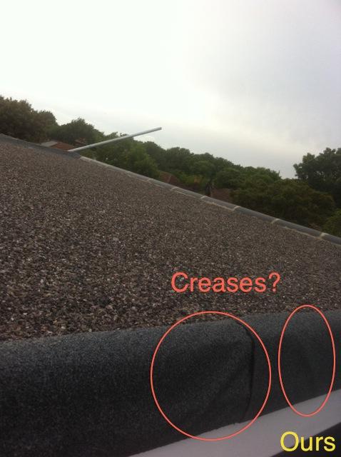

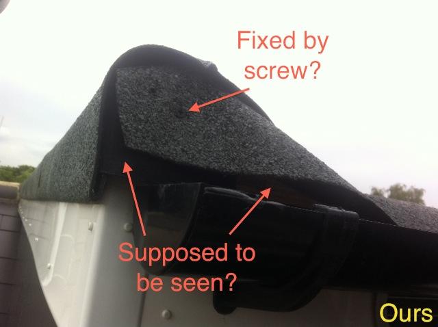

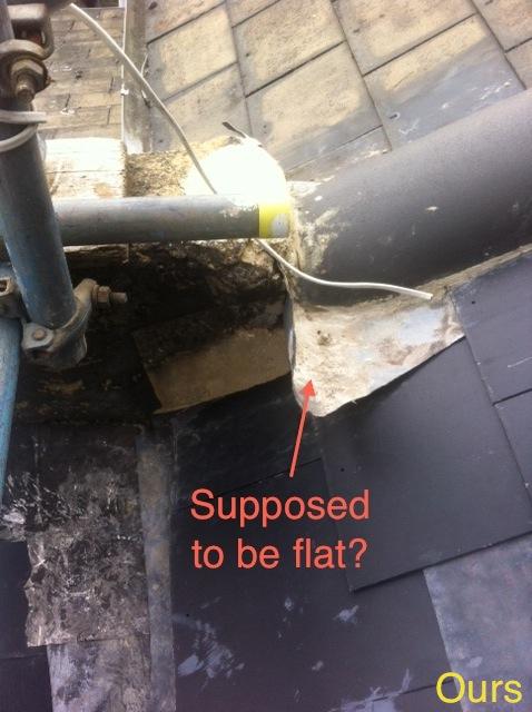

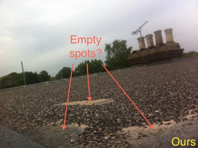

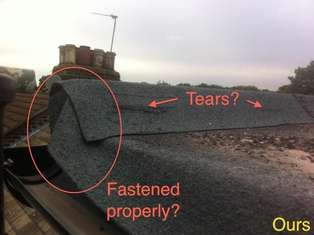

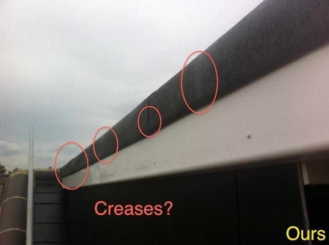

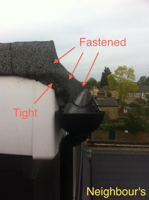

Hi all,
We recently had a dormer loft conversion carried out, and we're concerned on the way the felt was applied, especially around the edges where it meets the gutter. We are able to tell due to our neighbour also has one. So we've taken pictures with texts and arrows that show our concerns and we've also taken pictures of the neighbour's dormer felting so you can see the difference. Can you please advise us if our concerns hold any weight, and if so, what are the disadvantages associated to them if any?

I'm not a felt roof expert but some of those finished pictures do look a bit cack so I'll let the experts give you their version.

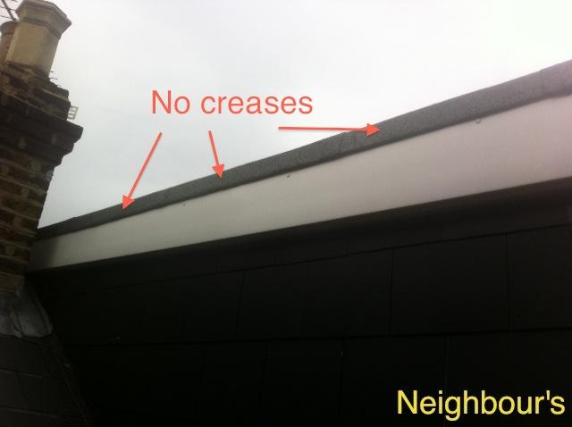

pic 4. shows the roof tight to a chimney stack - this will cause difficulties for any maintenance to stack, flashings or roof edge. The stack flaunching shows vegetation growing.
The roof cover is obviously rubbish - was this sub-contract "roofers" or the builder's work? If the builder did this roof or passed, it then what is the rest of the dormer loft conversion build condition like?
Is there even an adequate fall on the roof?
Dont release any monies. If the "roofer" has taken the money and their scaff then its doubtful you will see your money again.You need an independent roofing expert survey if you want to proceed further.
Thanks. If you're referring to pic 4 where it states no creases, that's our neighbour's one. And yes, I've booked a roofing surey for tomorrow.
Yeah, i see that now - but whatever, that proximity is going to cause future difficulties for someone.
