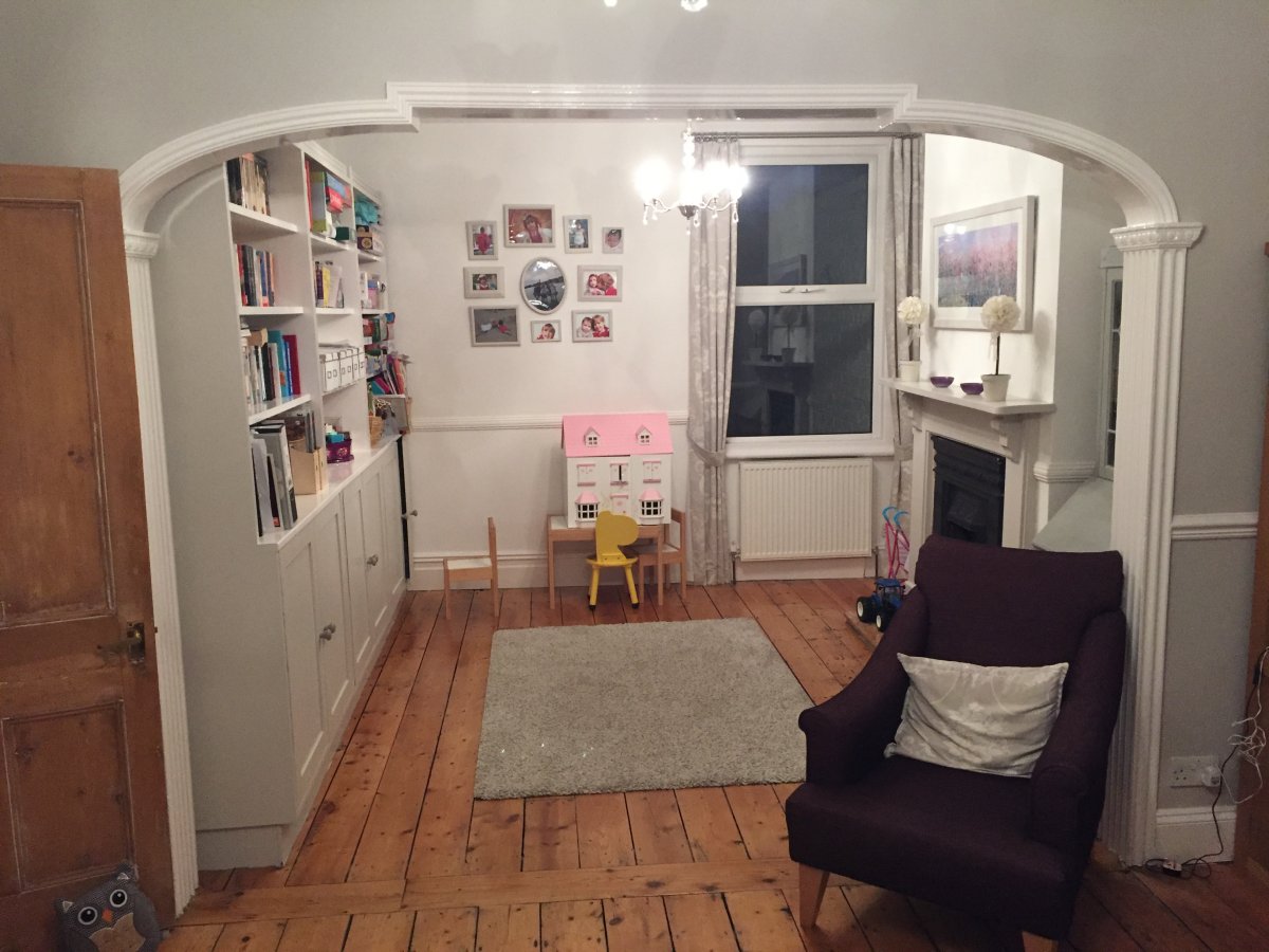

I have a victorian house where the front two rooms have been knocked together with an archway between them. I now want to split the two rooms with folding doors so that we can either use them as separate rooms or keep it as one big space. I've attached a photo of the archway and would be really grateful for any thoughts people may have on how best to achieve this. I'd love glazed bifold doors that fold back on either side to leave the whole space open but could also be closed. The problem is the shape of the archway and exactly how you achieve that (particularly given it's about 2.7m wide x 2.3m high). Any ideas on how I could do this would be great! Thanks in advance!

Glazed infill panel across the top then you can fit conventional doors to remaining opening which will be square.
Thanks for your reply. That's what I was thinking but don't know how you'd get doors to open- presumably a track of some kind? thanks
Depending what the wall is made of, you could go for a pocket door system.
