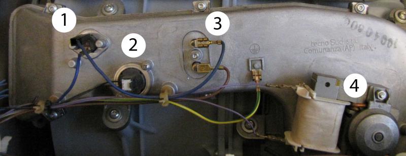

1. unknown ?
2. NTC thermistor
3. ? heater element ?
4. Fan
Does it get hot on the dry cycle. Does the fan go round. 1 is the one shot if it gets too hot it pops out.
Hi and thank you for your help
The dryer works, and blows air into the machine as far as I can tell, I hear the fan working.
The metal housing in the picture gets hot all over.
I opened the door and the test item and surrounding air was hot.
I have no idea what item 1 is in the picture (would not know what to order), it has not popped out as far as I can tell.
Can I test the item 1 with a multimeter, do I test for resistance or continuity?

The reason I have posted the picture is because F13 points to drying.
No need to test cos as you say it's getting hot. It would be cold air blowing not hot if it had popped. Have you cleaned the fan blades and the fluff filter on the back of the heater box.

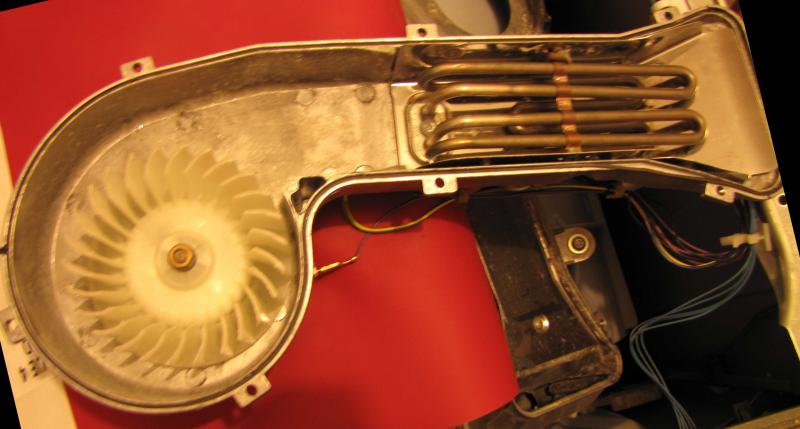

I took the heater assembly off:
The fan is clean and turns (visual).
The heater is working, it blows hot air into the drum.
The internals heater assembly is spotless.
I cannot see a fluff filter on the back of the heater box, but I see the inlet goes downwards?
