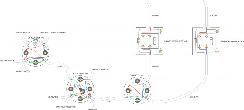

I'm fitting new lights and fans to my bathroom and I've come across a few questions I'd really appreciate help in having answered. Can I also say I'm not an electrician but I am having the wiring looked at as required to check the safety and regs-compliance etc. but I am intent on doing the work myself. I really enjoy learning new skills and understanding things better! :)
Basically, I am installing a wall fan with timer module, a shower fan with timer, 3 x 50W 240v Halogens and 1 x 12v Halogen with it's own transformer (due to the 12v halogen and the shower fan being a single unit - although the fan is powered seperately of course). I've installed plenty of lights in the past so no questions there, but the fans are new to me.
I learnt about how fans with timer modules have Neutral, Permanent Live and Switched Live and that's all fine too, but I am a little confused when it comes to installing a 3amp fused spur on each of the extractor fans. Both fans instruction manuals point out that these are required. I have been to a number of DIY outlets looking for a 3amp fused spur but only found 13amp fused spurs available - I'm guessing this is really simple, but I'd rather be sure I'm not doing it wrong - so is it just a simple case of swapping the 13amp fuse out for a 3amp fuse? Secondly, I initially assumed that both the Permanent Live and the Switched Live should be fused, but the fans instructions only shows the Permanent Live being fused. How is that wired up inside the Fused Spur Box? The Fused Spur provides terminals for Live, Neutral and Earth, but in this case there is no Earth, so is it a case of wiring the Permanent Live into Live, the Neutral into Neutral, ignoring the Earth and using a Connector Block to continue the Switched Live to the fan?
Oh, and one last question (probably daft, but I'm really curious)... I plan to purchase two fused spurs, one for each fan, but is it legally possible and safe to wire the two fans into one 3amp fused spur?

I thought it would be easiest if I drew up a quick wiring plan for the bathroom electrics. This is the method that I have been advised to follow by a qualified electrician, but with a couple of additions that he didn't know about (and nor did I when we initially discussed what I was having done). I hope this gives a clear idea of my wiring intentions. :D

I'm still very interested in knowing if my wiring diagram is any good though and if it would be safe and pass regs etc. I'll no doubt chat with the electrician about it when he arrives, but I'd still be interested to know what experienced members here think of it.
I can't get it big enough to see clearly what all the wires are, but are you trying to use FCUs to fuse down both the permanent and switched live in some way, as they only fuse one of the poles, so that won't work (and if you don't fuse down one of them then it's pointless having the fuse in the first place).
For the set up you want, I'd probably not bother with an FCU, since the whole circuit is presumably breakered at 6A, but anyway, if we must follow the manufacturers instructions then I'd take a feed off the lighting circuit, put it through one FCU, then take that in to a junction box where i run the cable to the switch etc. Then I'd have a 3-pole fan isolator (switches perm live, switch live and neutral) before the fans (one for both is probably fine).

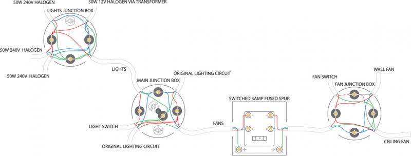

If 3) is correct then for a fan connected to a lighting circuit supplied with a B6 MCB then an extra fuse is not really required. However a means to isolate the fan is so some lockable switch is required. The standard fan switch does normally come with a device to take a lock but they are often lost. The FCU has provision for a lock to be placed in the open fuse carrier so is a very good way to provide isolation.

rebuke, I was thinking exactly what you have said about the single pole being fused. The instructions for both fans show only the permanent live being fused, but what good is that when there are three poles?

If you fuse the permanent live before the switch, then the switched live will also be protected - I suspect that's what the diagrams showed. If not, then it could be that due to the way it's wired, the switched live is only 'sensed' in some way, and it can't actually provide power to the fan, but I wouldn't rely on that...
A 3 pole isolator is not absolutely necessary, but they are useful for a number of reasons:
* If your fan breaks for any reason, you can isolate it and therefore keep the lights on
* You can do maintenance (cleaning) on the fan without having to turn off the lighting circuit (if you've got a window in the bathroom though this point is negated somewhat).
* If it's late at night, you want to go to the bathroom but don't want the fan coming on waking everybody up you can isolate it before turning the lights on (this one isn't relevant in your case though, since you've got the fan individually switched).

I see what you're saying rebuke. I've put another pic up, I only hope it's slightly more legible. One of the instruction manuals have the fuse after the switch, one is before. I think the one that shows the fuse being after the switch has simply made a mistake.
As ban-all-sheds says, the switched fcu would work as an isolator too.
