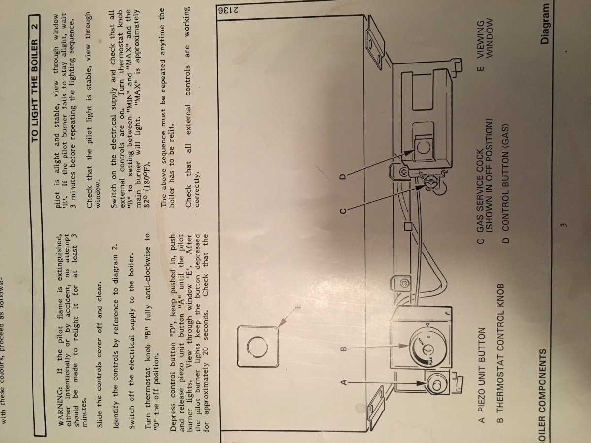

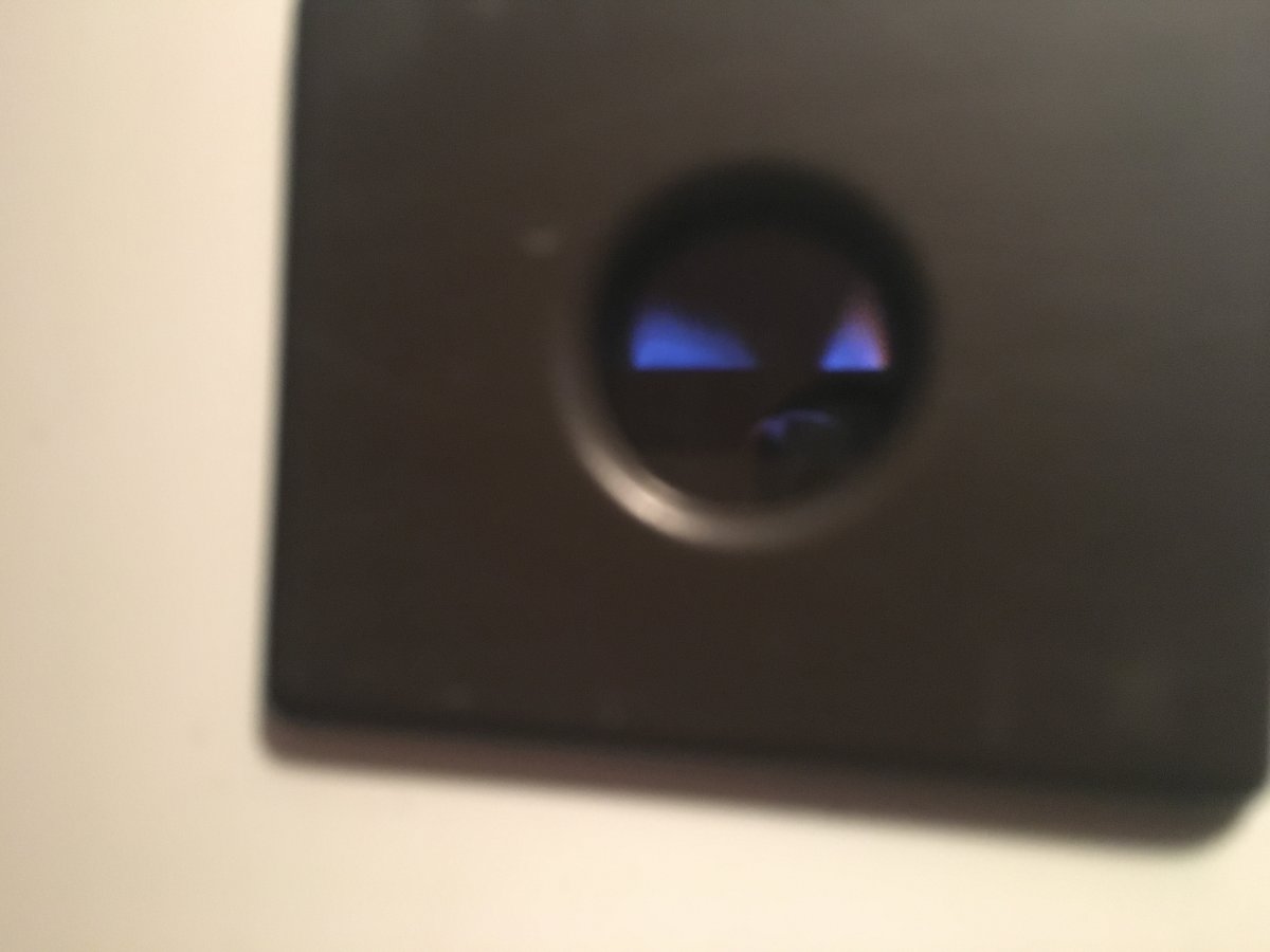

Hi,
I was wondering if someone could help me
I've got a Glow-worm space saver-r-series my II boiler that I can't seem to get the main burner lit on
It was working fine until my dad an I turned off the power to add some light fittings
The pilot light seems to be on (pictured) and I've run through the 'light the boiler' sequence pictured but no joy. Not sure what trick I'm missing
One of the buttons (marked D) is a bit spongey - I've tried both sliding it and pushing it and doesn't seem to make a difference
When I flick the little black on switch, it makes a low noise but much quieter than usual
Does anyone know how I get the damn thing to work? Feeling pretty stupid now after trying these instructions a ton of times

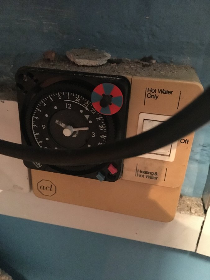

Can you hear the pump running at all, plus is there a programmer and a room thermostat fitted? Some photos of these and the wiring in the boiler would be very useful.
