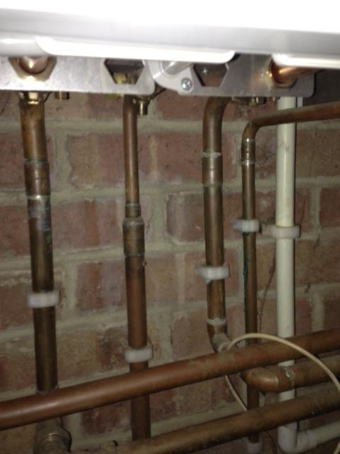

We have just purchased a new property and went to try the central heating a couple of days ago. The boiler is firing up but very little heat is going to the radiators. After leaving it on for about an hour a couple of the radiators were warm, however, the majority were still cold. We have had 2 different plumbers out....the 1st said he thinks it may be the pump......the 2nd has said that he thinks the pipes going from the boiler to the radiators are too small and are only likely to be able to heat 2/3 rads. We have very little knowledge on this so really dont know what to do now......any advice would be greatly appreciated???

Yes, we do have a motorised valve (underneath the boiler). The grey things in the airing cupboard are pumps for the shower and taps in the house.
Could we have pic showing the pipes connected to the underside of the boiler?
Sorry, you are correct, there are 4 pipes coming from the cylinder. I have attached several photos of the cylinder and boiler, hopefully they will show you what you need to see, if not let me know. Thanks for all of your help.
The flow and return pipes connected to the boiler seem to be 22mm, so I'm confused about which pipes the installer say are 15mm, apart from those connecting to the rads, which are normally 15mm.
