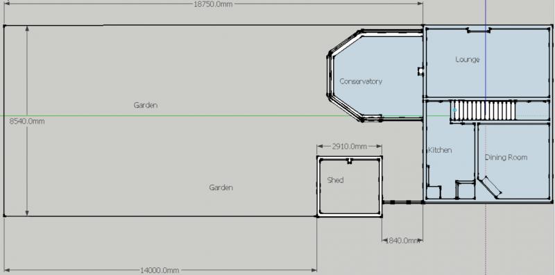

Here is the current layout of the ground floor with the shed which is about 1800mm from the kitchen door.
There are two issues I can immediately see with building where the shed currently resides :
1) this would mean we are effectively building right on the boundary line, but should this be an issue given that we are only replacing one structure with another?
If we have to come in a metre from the boundary that severely limits the space available.
2) The current shed is 3m in length and therefore extends a total of around 3.75m from the rear wall of the house. I understand the guidelines used to say you can come out no more than 3m from the rear wall, but the new regulations say that - at least between May 2013 and 2016 - I can now go up to 6m - is that correct?

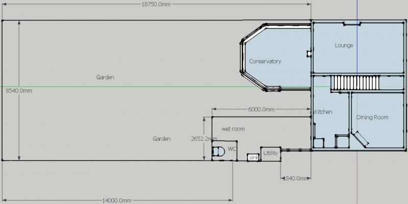

Assuming the above are not an issue my proposed extension would be something like this:
The alternative if I move everything over 1m is the extension then blocks out any natural light from the one window in the kitchen and gets uncomfortably close to the conservatory - would literally just give enough room to open the conservatory door.

You certainly don't need an RIBA for that sort of job; a good local technician would be capable of doing that for less. Architects like doing fancy drawings; you need someone who knows building construction and the Building Regs.
No - builders won't quote for a job unless they know exactly what's needed, and that means detailed plans.
You can go right up to the boundary with your extension.
Up to 3m beyond the original rear wall doesn't need planning permission; between 3 and 6m, the neighbour consultation scheme applies. In essence if none of your neighbours complains, you can go up to 6m max.
Aye a technician will be more than adequate, provide they are good. That said there are actually plenty of good and non expensive architects out there (think one man bands not firms) Likewise I have worked with plenty of technicians who are shoite. Look through the planning applications where you live and see who is doing all the applications, often a few regulars will crop up.
