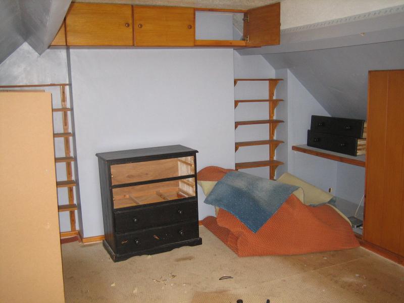

My intention is to do the conversion myself, apart from the steels installation, bricking up of the gable window, fitting the fire doors, electrical certification and plastering. That still leaves me with a lot to do, I anticipate it won't be complete for 6 months yet. Here's some pics of the original conversion....
Stripping the old conversion revealed some rather terrifying things, like the electric shower cable which ran under the floor that had completely burnt out due to usage of a tiny connector block or the usage of 3 phase cable everywhere (how he wired them up I don't know, 3 phase wires are all black)! Worst of all though was the gable window, which had no lintel above it, one of the purlins was almost right above the window, I'm amazed it's still standing!
The floor also bounced like a trampoline due to the woefully inadequate steels that had been installed, and the staircase headheight was so low that even the shortest person I know has to duck :rolleyes: The insulation consisted of loose fitting polystyrene and about 100mm of fibre glass wool compressed down to about 25mm, I suspect the room was very cold since he'd also installed 4 radiators :p I've now removed all of it apart from the staircase, and I'm into the construction phase of the project...

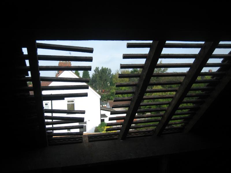

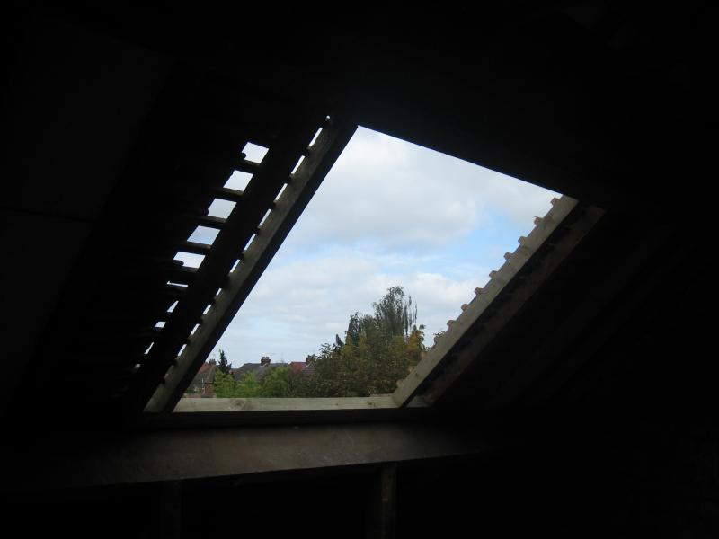

First rafter removed, I was a little nervous doing this!
Other 2 rafters removed...
New trimmers fitted and rafters doubled up...

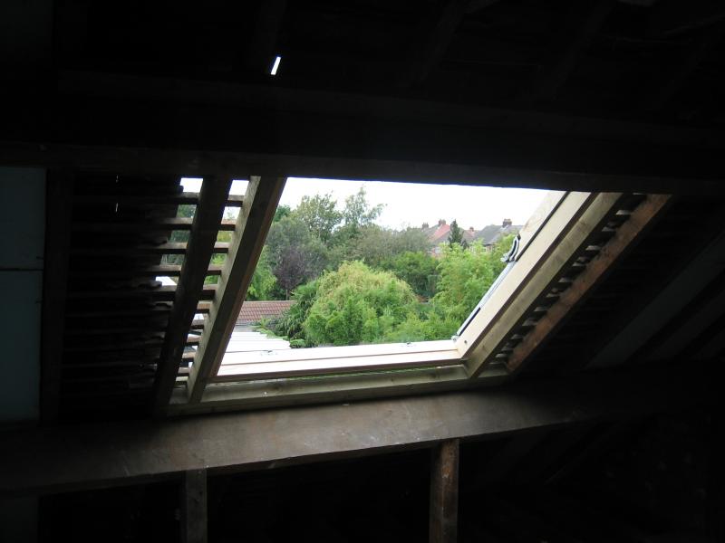

Window frame fitted...
Window in!
Flashing complete...
My new view :mrgreen:
The window itself went in suprisingly quick, about 5 hours, but I spent another 10 hours fitting the flashing (lots of tiles to cut and drill). It's been torrential rain here today and I'm happy to report not a single drop made it through :) 2nd window is going in next weekend, in the meantime I'll fitting some of this huge stack of celotex....

Just a quick update, second window is in now, as well as the first layer of insulation...

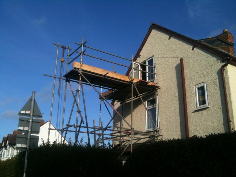

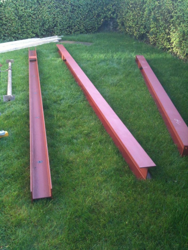

It's been an exciting few days, the builders have now nearly finished, they just need to return on Monday to paint the outside of the bricked up window and remove the scaffolding. I expected they would have used a crane to get the steel in place, but instead they set up a scaffolding and pulley system...
This involved first getting the steels perpendicular to the house, but the hedge was in the way, so they just laid a scaffolding board on the hedge and slid the steel onto it until it was balancing on top! Hedge is a little squished now, but I'm sure it will rebound in no time :p
The steels were hauled up with pulleys and pushed through the window, out through the holes in the far wall, then back into the first wall (this meant there are no external holes on the visible side of the house).
There's still one beam to install in that last photo, the building inspector seemed quite happy with everything so far, but rather unnervingly didn't really ask any questions (or say anything infact, I had to specifically ask him about each detail he was there to check!). The gable window is now bricked up too, which I'm quite sad to see go, but was necessary to ensure the stability of the wall.
