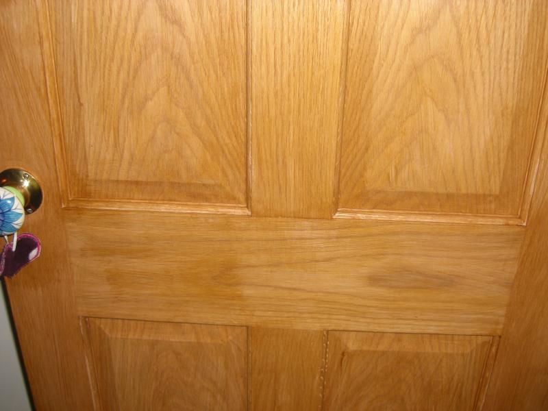

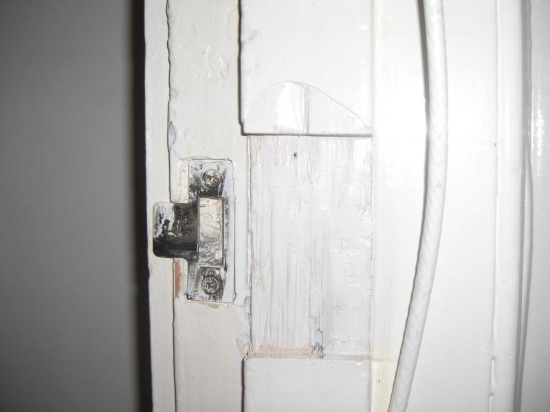

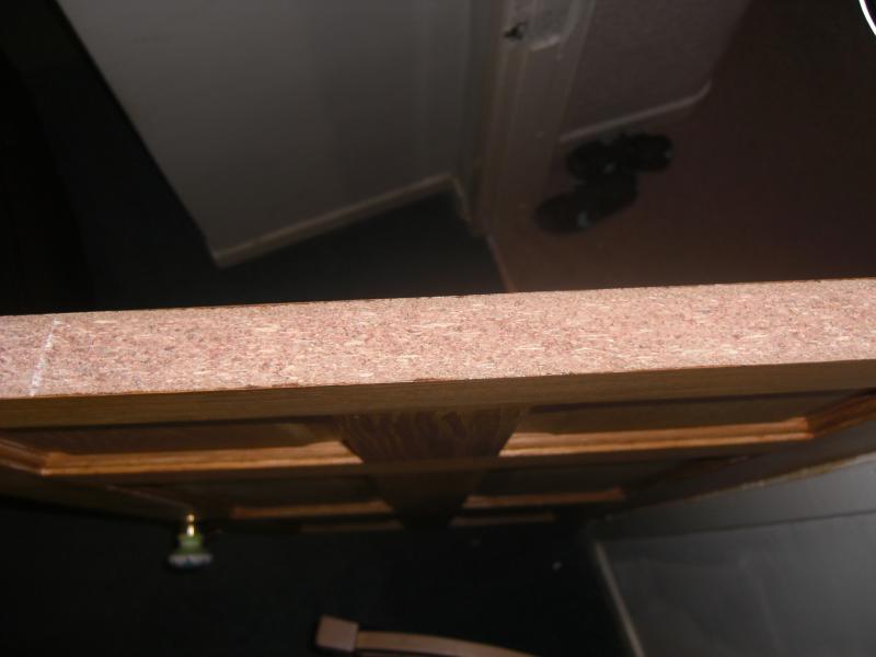

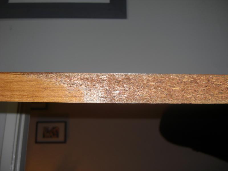

The first one is the streaky varnish, the second one the chunk hacked out the door jamb which I then had to samd down and paint myself, the third one is the top of the door which is down to the chipboard and not even varnished and the last one is the side of the door, a tiny bit of venner left at the top, the rest is open chipboard which although varnished, catches my clothes and scratches my hands.
Veneered doors are only really satisfactory if none - or a tiny bit - of the veneer is planed off. The results are obvious and to be expected.
Pic 1 - not the correct treatment for the door, and poorly applied. It looks like a polyurethane.
Pic 2 - I've no idea why he hacked out the bit of door jamb - it looks like where the original lock keep has been? Either way, I'd have filled it with a sliver of 3mm plywood.
Pic 3 - The door top is almost acceptable, but at least should have been varnished to prevent dusting. To be fair, the door frame could have been askew.
Pic 4 - Ghastly....he didn't choose the right door for the job but someone who knows what they are doing 'could' have faked it from the hinge side. No excuses there.
This is the sort of job that is an insult to a professional joiner. Apart from the varnish finish, I doubt if he would be capable of making good.

The edge of the door was actually a strip of real timber which he has planed away...its not really replaceable.
The only real way was to use a solid timber door, but thats all very well in retrospect....at least solid timber doesn't look like this one after it has been planed!
