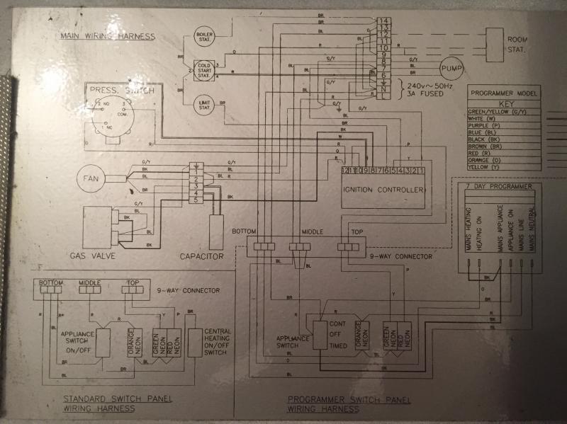

Good morning everyone
I am facing a peculiar problem in the new house I've moved in and would like to understand whether this is normal behaviour or not...
I have a Potterton 185 Powermax boiler with the integrated programmer. Also a room thermostat wired up to the boiler.
Now the problem. When having CH ON on the programmer and Thermostat off (even physically disconnected) and running the hot water, heating fires up to warm up the internal tank. However my radiators are also hot!
If I have CH to OFF then the radiators are cold when running hot water.
Thermostat is getting power when CH is ON and when CH is off it is not. Also it does indeed control the heating, only when the heating is not on for hot water!
So is this normal or there's something wrong? What should I look at as its driving me crazy :)

As all the wiring is pre installed, I think we can rule out a fault there. If as you say you physically disc the room stat, have you checked the room stat connections at the boiler? My suspicions are still with the diverter valve.
I've been trying to get my head around the wiring of the boiler whilecwaiting for the engineer to try and fix the issue. I've attached the wiring diagram but can't seem to find the diverter valve on it, any clues?
So boiler engineer came over and the problem was far more "interesting"! The previous owner had installed a relay between the thermostat connectors on the boiler and the gas ignition point on the boiler! So whenever the ignition was on the thermostat controls were overriden and the heating was on! Needless to say that this contraption was removed.
