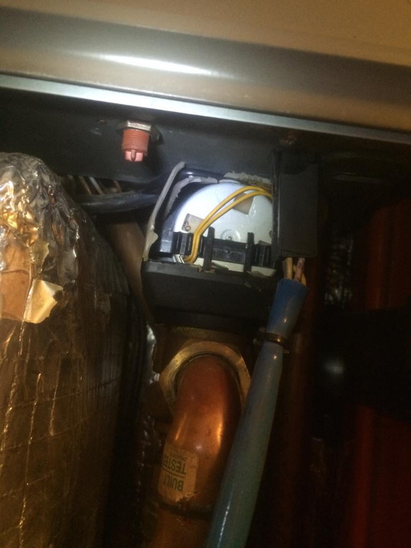

I have a heatslave 20/25 oil fired boiler. Yesterday it started rattling. Closer inspection revealed that the sound is coming from the Actuator. At best it's a buzzing sound, at worst, it sounds like someone is firing an AK-47 off.
The sound is definitely coming from the actuator, as the housing is broken and you can see it. (see pic).

If the actuator is buzzing then it is at least trying to work. I'd purely guess that the thing the actuator is trying to move is frozen, i.e. the valve?
Can you remove the actuator and try to open / close the valve by hand? Bet it needs a bit of force...

Remove the actuator and you will be able to see whether the valve is stuck, quite common on this valve. If there is no discernible up and down movement of the valve, you will need a new cartridge, which is a drain down job. If you are lucky, there will be isolation valves so you only need to drain the boiler. With such a battered actuator, it would be wise to replace that also.

Again, guessing here but it seems like the valve itself is stuck in the correct position for heating. When there is DHW demand, valve needs to move, can't because it is maybe stuck and hence the actuator starts straining (i.e. rattling).

Bet you 5p that replacing just the valve will solve the problem of the rattling actuator & hopefully the rest of your problems. I take on board oilhead's suggestion of replacing the actuator too due to stressing: BUT if it is OK, why go to the expense of replacing it?
IF it is a stuck valve, question remains then as to WHY it became stuck? Take a good look at the old one if you decide to remove & replace it, as this could suggest pending future problems elsewhere maybe?
Andy
The spring loaded cartridge on this valve is a common failure. It is also used on some stelrads, and a good stockist will direct you to this item rather than the Worcs unit. The seizure usually will be as a result of system contamination, and would probably benefit from a flush and fitting of a magnetic filter. This would also protect the pump and water jacket, to say nothing of the radiators and valves.

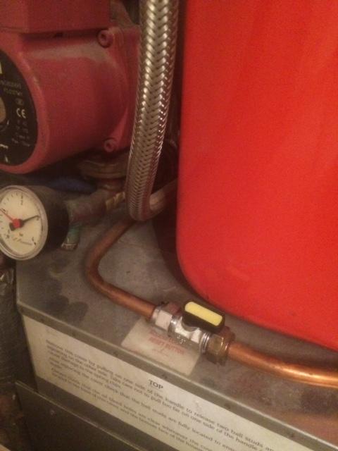

Unfortunately I've found another issue today which I guess explains the pressure loss. This morning I charged the system back to 1.0bar before I went to work (as it dropped again to about .5)
Mrs has had the heating on all day and the system is currently showing 3 bar, However, The pressure relief pipe outside is dripping out water (it's at least filled the cup that I put there this morning!) I assume this is now a separate problem, or is this likely to rectify when replace the valve cartridge and drain/refill the system and recharge the expansion tank?
I've noticed that a valve underneath the expansion tank has been left in the open position by the engineer who serviced it last year... this is a cold pipe, should it not be closed? (the external refilling hose valve is closed)
I did tell you what to do about the pressure problem in my last post!! EXPANSION VESSEL re-charge with air.
If you turn off the valve below the vessel in you latest pic you will introduce yet another fault as it is the fuel supply to the burner - don't knock your Service Engineer for leaving that one on!!! :evil:
Yes I've just realised that now when I took the burner cover off! He's a good guy that engineer.. feel a bit silly now.
