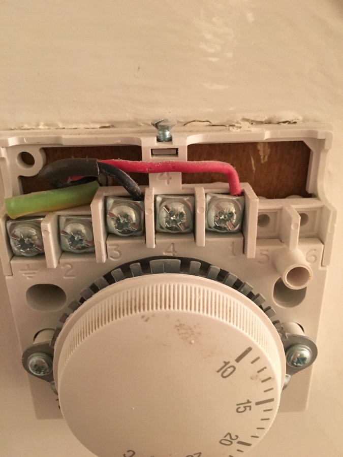

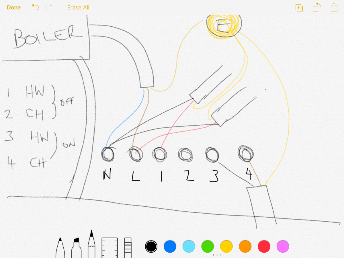

I'm trying to install my Nest thermostat by replacing my LP112 controller. I'm a bit worried and don't want to send 240v to the wall plate. Can anyone help me identify which cables head to the current room stat from the attached diagram?

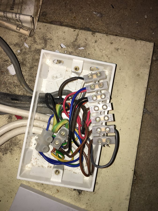

None of them - the cable you need will be inside your wiring centre in your airing cupboard

Totally understand.. I've watched about 30 videos and looked at loads of wiring diagrams. I'm fairly confident with wiring etc but I suppose I don't really know what type of system I have (Y? S?) so I know I'm looking at the right diagram
Y plan looking @ that backplate...then again it could be an S plan that utilises a MOMO valve for HW.:)

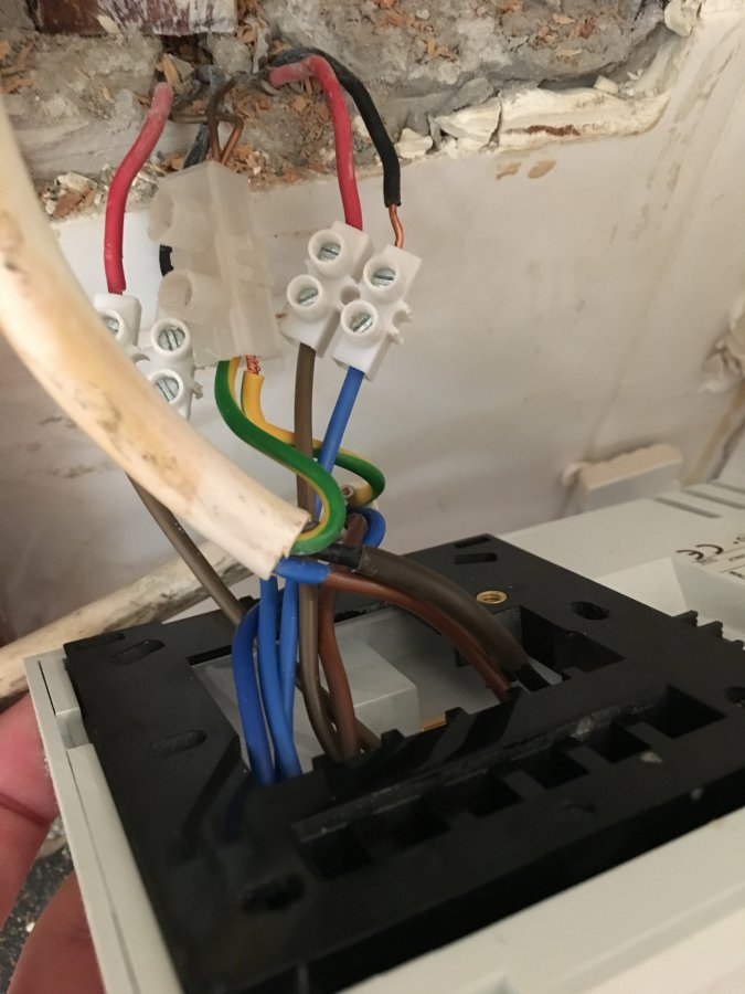

The flex that carries the wires connected to 3, 4 and Earth.....can you show us a picture of it, plus at the other end where it is connected into the wiring centre.
A pic of the wiring at the back of the room thermostat would also be useful.
There are much cheaper items readily available which do the same job apart from connecting to a phone (normal programmers, timers, thermostats etc)
Hi Jackthom.. thanks for the help. I have attached the pictures you asked for. I hope they are clear. The wire centre in the loft is a real mess in terms of being able to identify anything. The flex pictured going into the controller has a blue wire cut off.
