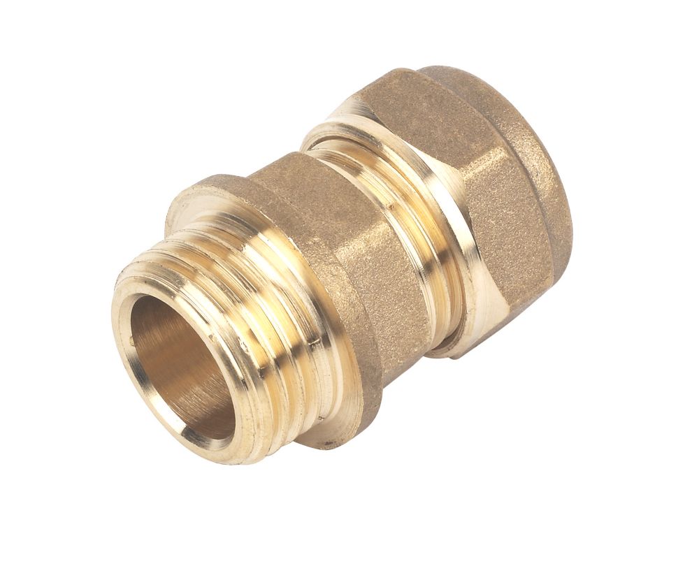

yup you need to ether re-use the tails that are there if they are the same size or remove them and install 2 of these -
ae235
Your new tails will attach to the male end of those. You won't have isolators after it though.
Alternatively if you wish isolators, the ideal job would be to remove your current flexi tails, install 2 isolator valves on the ends of the pipe, add these to the other end of the iso valve
and then fix the flexi tails onto them.
Oh and re-orientate the supply pipes so there are no kinks in the flexi pipes!
