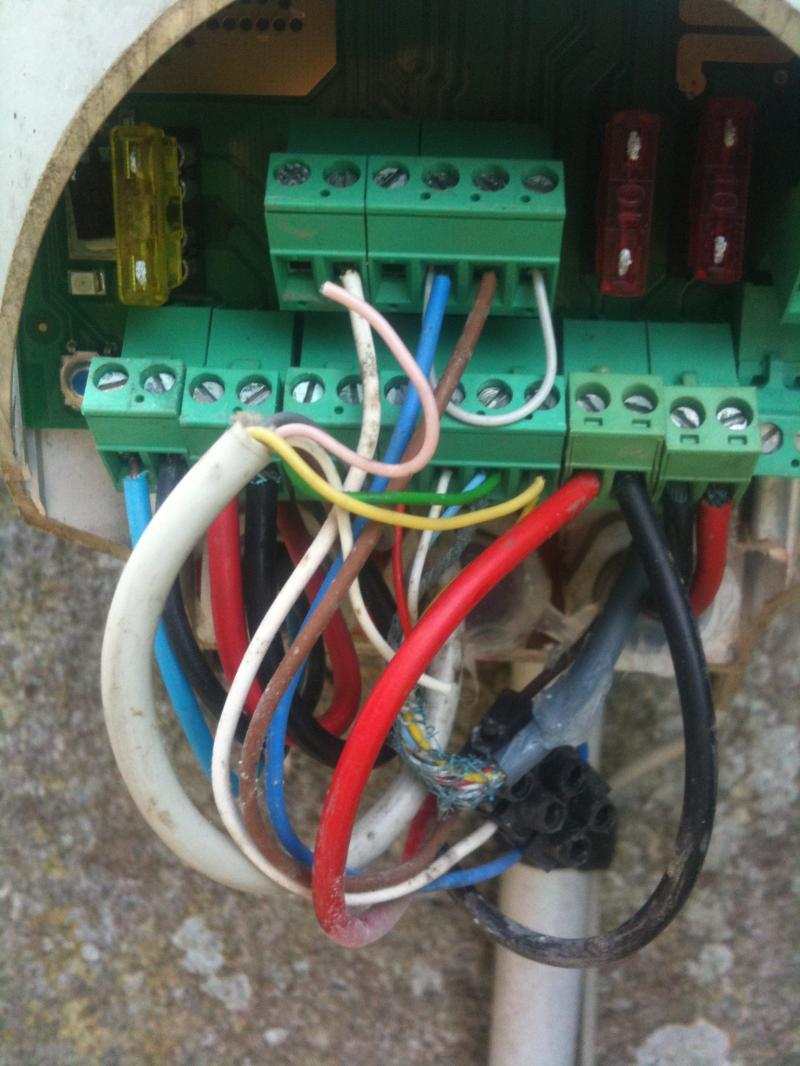

This is a photo of the business part of the Daitem.
For the lower row;
From left;
Blue/black = input power (seems to be 15V AC, odd?)
Red/black = unit power = 13.8V DC
small brown/grey = power for keypad etc was taken off here
small red/white = not sure
small green/yellow = think this is where Daitem receives signal to open
red/black x 2 = power out to gate motors
For the upper row, not sure, but think it is control for the gate motors, eg. stops them if infra red beam is broken, etc.
Thats the wiring diagram for the main unit.
The top as you say will be the commands. The white wire link will be a total/emergency stop, so leave that in place or everything stops working :D
Get wire link, old bit of cable, conductor showing at both ends and short out the first pair, see what happens. You are looking for a open, stop. wait, close, stop action, thats the one to link to the videx.
Or there will be a stop, open,stop,close,stop thats one touch control if you do not want automatic closure.
That should be that.

Wired it up today, but no joy. Here's what I did;
1. Connected my green and yellow wires to C and NC on the Videx. Then connected them up to the Daitem where you see the green and yellow (posts 9 and 10). Just doing this triggered the gate to shut, then whilst getting the wire in properly, it then opened. Nothing more.
2. Then connected power (using posts 3 and 4) (5 and 6 are now empty) to the Videx, which seems to function correctly. The keypad programs OK and sends a signal when you put the right code in. However, the Daitem now seems 'dead' - it won't open or close. I tried swapping wires (green/yellow) and NC for NO, but no effect other than it makes the orange light flash continuously. Also, the remotes no longer work (they did yesterday!)
The wiring diagram you posted doesn't really correspond to mine - I'm not sure what post 7 and 8 do for example (red/white cable).
Help! I am now officially stuck!
(By the way, the only reason I attempted this was that a friend said it would be easy - just a few wires to connect...........!
Sounds like you disturbed that white wire link at the top, it is a TOTAL STOP EMERGENCY function. Put the link back in it should all work.
Just to conclude this thread - I should have wired into posts 5 and 6, not 9 and 10.
Had to get the Daitem man round to breathe life back into the Daitem which had gone into shutdown mode, and then all was well.
Videx works great now.
Thanks for help.
