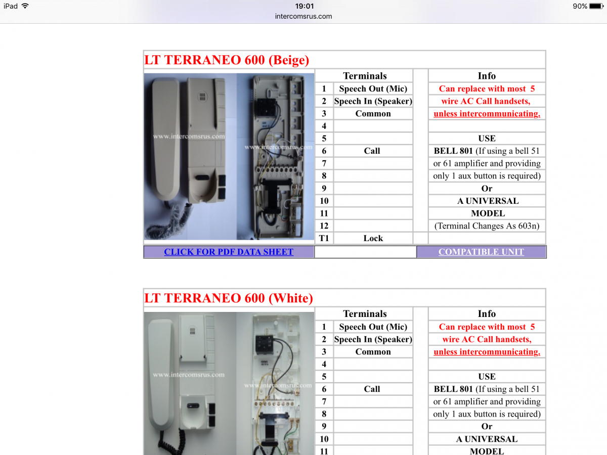

So basically I'm planning to replace a 1989 terraneo door entry phone with a new universal fermax model. I've taken images of the back of the old one and new one and I'm struggling. Lots of trial and error, at the minute all error though. Any thoughts or advice?

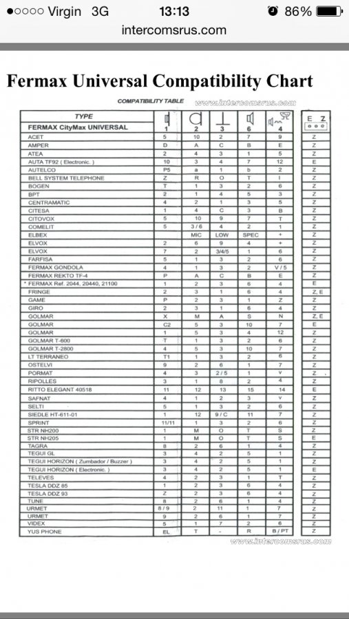

Use the supplied chart to rewire new handset

To be honest these universal handsets are not always 100%

Thanks for your suggestion. I do have this table which came with the fermax one. However it doesn't help. My old terraneo has 6 wires going in but the new fermax only has 5 terminals. Also the numbers on the table don't match the terminals used in my old terraneo?
