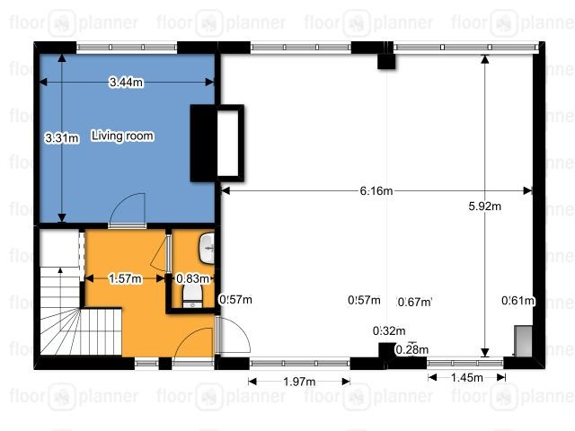

Proposed Floorplan:

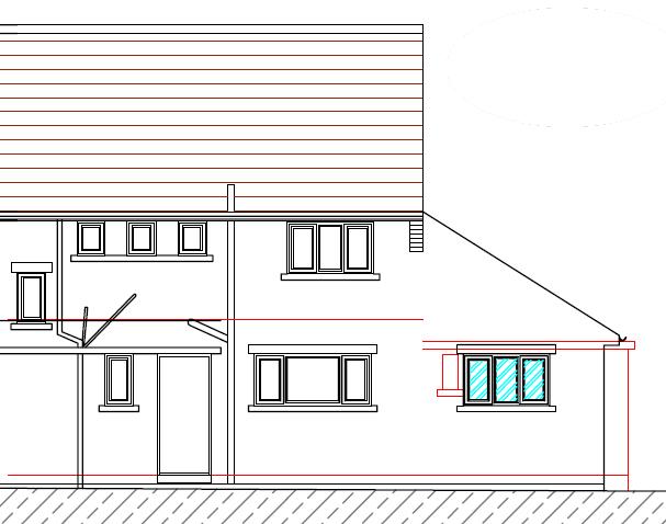

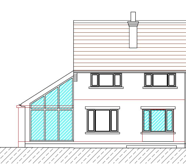

Proposed front of the house:
Proposed back of the house:

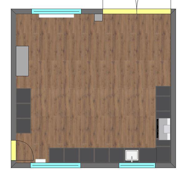

This is the kitchen plan showing the proposed radiators if I don't do the underfloor heating - there will be one radiator under the back window (existing location), a little one next to door and a plinth heater under the sink:

Make sure you know your kitchen layout as well as any island or peninsulas as its best not to lay any pipework under units.
