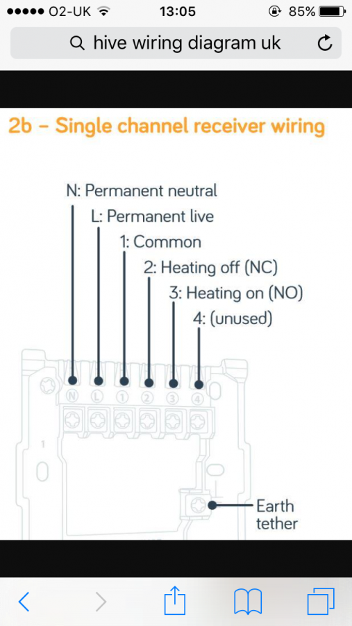

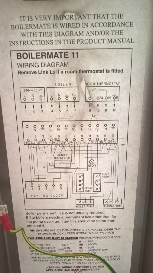

Hi all, I've bought a hive c1 system and I'm trying to wire it into my boilermate to control the heating. I've included the wiring diagram.. So I can ser how to remove the exisiting thermostat by reconnecting L2, I can see where the heating clock is and that I want to swap it out for the hive receiver...
live and neutral are obvious, but where would I find NO, NC and common?

Common is 3 on the 'heating clock' which as now is just linked directly to L
NO is terminal 4 on the 'heating clock'.
NC is not required.
