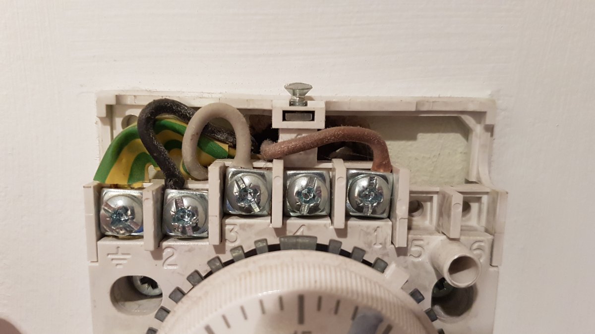

Hi all, new to the forum so please be gentle. I'm normally pretty good at things like this however this has me stumped.
I have bought a hive smart heating system but I'm struggling to work out the wiring. I've googled for hours but haven't found an answer to what I'm looking for.
My current Honeywell thermostat has 4 wires going to it... Earth, brown, grey and black. I wired it up to the hive receiver as I thought it should go however nothing worked. From searching about I think I need a netural for the hive to power up.
Can anyone please point me in the right direction as to what I need to do?
I have attached a picture of the current Honeywell thermostat. The hive unit I am hoping to install is a SLR1
Thanks in advance
Do you think I can just link from terminal 2 to the neutral connection on the hive receiver then?
Nothing lit up when I wired it previously and was not detected by either the controller or hub so I put the old manual thermostat back on so we don't freeze to death while I'm trying to find an answer
I am guessing from what you have written that the old thermostat does not actually have the neutral connected, that's why I pointed out it would work without one. You need to check if there is really a neutral. As to if you look where cable goes into boiler, or you use something like a meter or old desk lamp to test is up to you, I don't know your skill or what equipment you have.
If you have a programmer it may be wired back to that rather than boiler. It could be some one in the past did not know what they were doing, and many seem to think if it works it's OK.
Thanks for your reply. I am an audio visual engineer by trade however not a boiler or heating engineer so this is all new to me.
The boiler itself has a timer built in however is doesn't work very well at all.
I was hoping to replace the thermostat in my lounge with the hive receiver that will act as the thermostat as well as the timer etc.
I'll get my multimeter out and see what I've got as the wiring back to the boiler is all hiden and too deep inside to be able to see what's what.
Thanks again for your reply, I just wasn't sure if I could bridge across to get the netural from elsewhere
