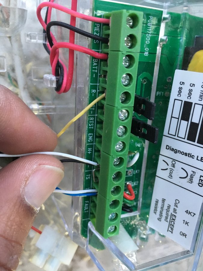

Hey guys! So I have managed to obtain a brand new bell box/siren (with the clear plastic back) and wanted to know if there is a way to silence the current external bell box completely to give me time to remove the old bell box and fit the new one?
I have tried putting the panel in engineers mode, but as soon as I remove the cover the alarm sounds. I can hold down the tamper switch to stop the bell from ringing, but it makes fitting the new bell difficult.
Any help would be greatly appreciated.
Cheers.
Ear defenders
Pair of snips and a screwdriver
Unscrew old unit and disconnect to fit new unit.
On the old metal box type sounders there is a black wire that loops round into a terminal marked Batt. Cut this first then cut the HO+ wire. That'll silence old siren. Make notes of current wiring as your need it when wiring new unit.

I have been told that the strobe light that flashes on my bell has never been connected.
The engineer that fitted the alarm originally used 8 core wire, only using 4 of the 8. I can't understand why he wouldn't have connected the strobe.
Am I right in thinking that I can use one of the 4 spare wires and connect it to the ST- terminal and the connect the same colour wire to the control panel?
If this is the case then will the terminal on the control panel also be marked with ST-?
