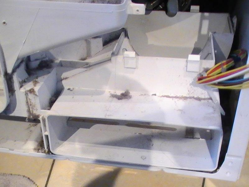

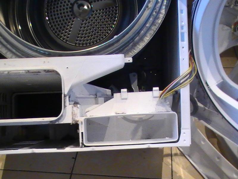

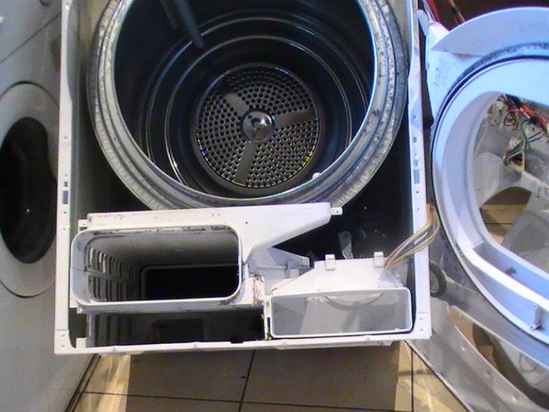

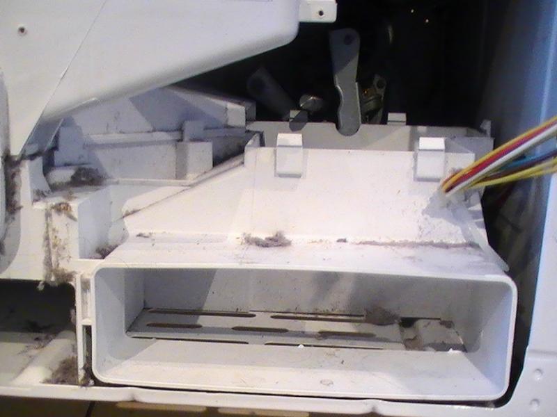

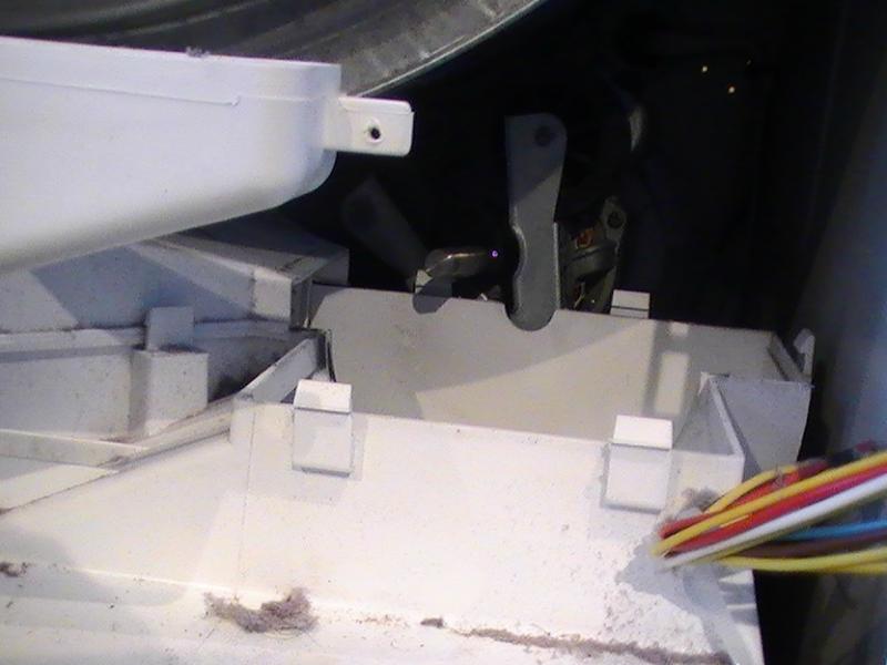

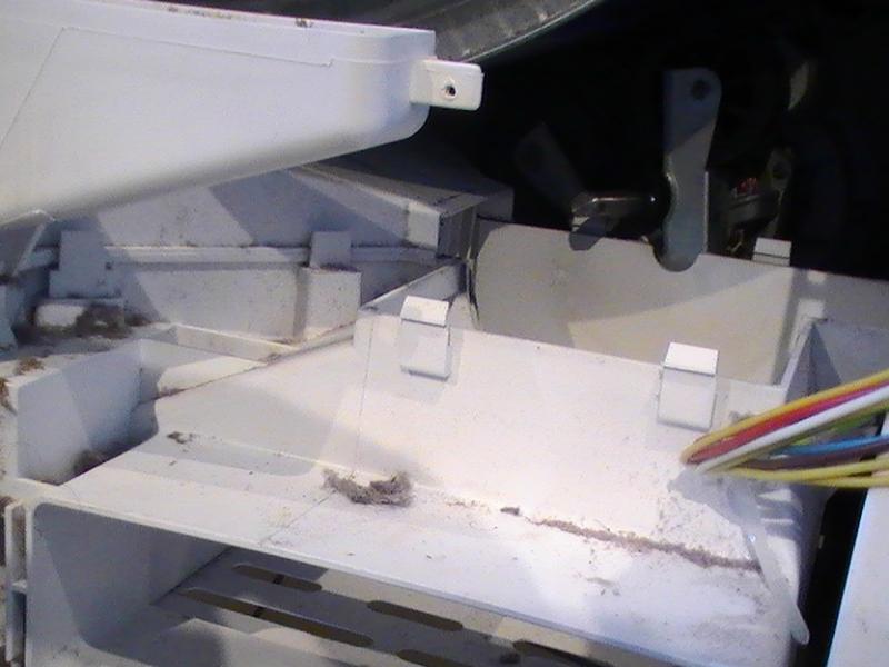

Hi, i'll attach a photo so you can see my problem. i don't know how to get any further. I can't get the plastic casing out to get at the motor.
I can't see a great deal of detail, but the white plastic bit on the lower right has to be removable to change the jockey pulley's on the belt tension assembly anyway. If so then you ought to be able get access to the capacitor, but you may need to remove a fan & screws/clips. Take some better close-up pics looking downwards at the right hand side. I don't have any drawings...only my memory.
Ok; to save time & needless typing....If you can reach in & release the belt tension on the jockey pulley's (the 2 black wheels) do that. Then slide the slack belt over the drum & take out the whole thing.
Thanks, i've gotten it out when i released the belt. It says its a 7.5uF. Should i get the same capacitor. It had actually burst and was leaking. I'll get the capacitor tomorrow and attempt to put the whole thing back together again. When i put the motor back on does the belt go in betwen the two cogs on the motor again. And is there anything else you can think of that i need to watch for when putting it together.
