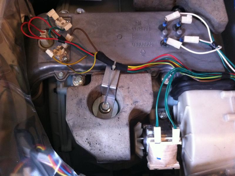

Our Hoover Optima Nextra 6 HNWL7146-80 stopped drying although everything else works fine. Does anyone know where and how I can find the fault or the manual and would it be the thermostat, cut off switch or an element?

Check the stats on the heater on top of the drum, does the fan motor turn for the dryer.
On top of the dryer heating element you have several thermostats, check to see if any of these are open circuit with a multimeter.
Then check to see if you have continuity through the dryer elements (should be around 27 ohms)

I have now checked the fan and it works. One of the dryer elements does not show continuity, the other about 20 ohms. I can only see 2 (see image uplaoded)
I posted a photo of the top of the unit as I am not sure where the thermostats are located? Can you advise please? I took the 2x right hand units as the elements, but it might be the other way round. How do I test if the stats are open?

The thermostats are small round or square objects mounted on the heater box with wires going to the terminals on them.

Ok the two heater elements are on the right hand side of the pic and the three thermostats are on the left hand side.
The one with the red wires is a one shot thermostat while the other two can be reset. All should have continuity through them
Ok the two heater elements are on the left hand side of the pic and the three thermostats are on the right hand side.
Thanks, state of affairs:
I have continuity through 1 of the 2 elements, not a beep or movement on the other.
I have continuity thorugh 1 x of the stats, the one with 2 x red wires...
I have a beep and it starts (ohm measure) then drops to zero on the stat with green wire, and no continuity whatsoever on the small stat with the yellow wire.
I see the stats can screw out (to be replaced I assume) but now the elements....?

I think it is sorted as I reset one of ths thermostats and there is a lot heat generated from the elements when I have it in drying mode. I will give it a full test tomorrow!

typical reasons for the stats blowing are lack of circulating air through the heater box
either due to blocked heater box (fluff etc)
overloading the drum which prevents the air getting round the clothes properly
heater box fan failure.
