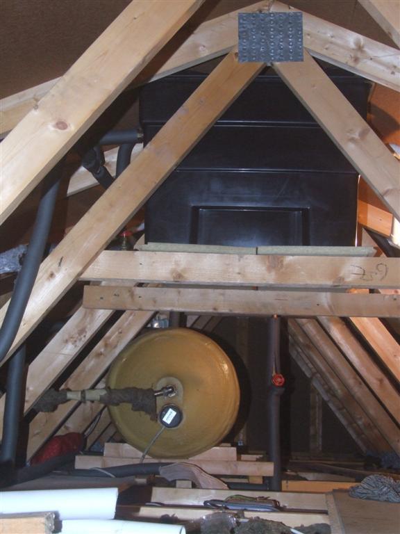

Hot Water Tank fitted on it's side???
By the look of the photo it is not even an indirect cylinder which would have certainly not done the rest of your system any good. I would do as you suggested by removing the lot and fitting a combi boiler. you will probably have to renew all readiators and flush system atc.

Scottish plumbers seem to be quite inventive where they put HW cylinders, I used to live in a flat that had it straddling the wall between kitchen and bathroom (so a bit poked into each room, not above the ceiling) and another house had it perched on a scaff pole across the top of the shower enclosure.
I just don't have a good feeling about that one lying on its side.

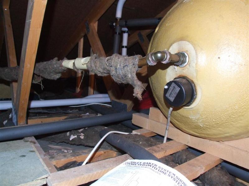

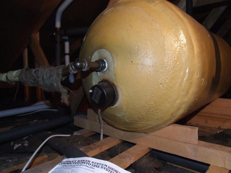

There seems to be a fair bit of scorching on the element and the mains lead...and maybe it's the camera angle but that water feed pipe does not seem to be fitting into the inlet connector squarely. (Apologies for the use of non-techie terminology!!)
There is nothing right about this installation, the sooner you get rid of it the better.

Think about it, you would have to have an air vent on top of each loop of the coil, thats why the annular heat exchanger is fitted in cylinders that lay on their side.
Not necessarily. If you can get the water velocity above about 2 fps (I think it is) the air will get entrained in the water and the bubbles are removed. Once the air is gone, it shouldn't return.
An air vent on all high-points is good plumbing practice and a conventional cylinder installed horizontally would be prone to persistent air-locking.
An air vent on all high-points is good plumbing practice and a conventional cylinder installed horizontally would be prone to persistent air-locking.[/quote]
