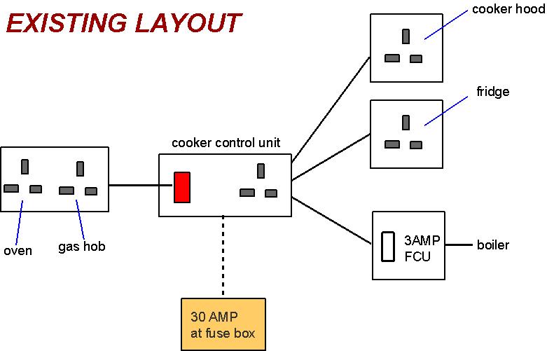

Actually - and I'll check this - I reckon I have two radial circuits in the house, not a ring. We live in a 1 bedroom flat. One radial for the sockets, and one for the kitchen. How does this change things!?
max amps per radial is 20A if run in 2.5mm cable (which is usual)
You can hang additional sockets off a radial more simply than extending a ring.
You are unlikely to use this much except if you have two or more large appliances such as:
Washing machine, tumble drier, dishwasher, oven, fan heater, kettle, toaster
in use on 1 circuit at the same time (they take about 12 amps each while heating) so I would consider it a bit underpowered for a typical modern kitchen.
max amps per ring is 32A
I like rings.
If you post a pic of your comsumer unit, meter, company fuse and teh cables around and between them, we can form an opinion about your installation.
Are you sure the boiler is on the kitchen ring and not on its own radial, check your CU
Just checked, and looks like I have a 30A radial for the kitchen. Diagram here:

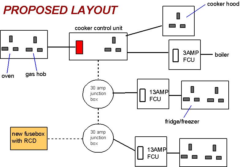

So, basically I need to add in another couple of double sockets. How about this?
I'll get an electrician in to do it, but I need to fit the kitchen units asap, so if I could have the cabling and sockets ready for him to connect, that would be ideal. And I'm assuming that replacing the existing Wylex fuse box with a modern RCD consumer unit wouldn't be a big job for a pro.
Thoughts please!!
