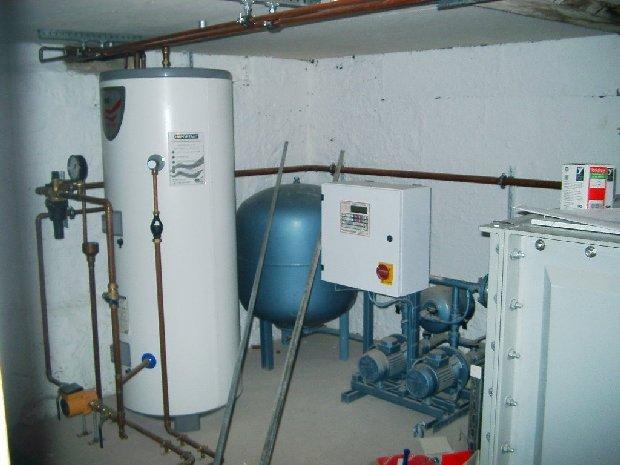

My two suggestions are not 'just plain crazy'. I was suggesting one 500 litre twin coil cylinder, each coil of which can transfer 70kW, and a single boiler of adequate capacity to heat the building. How you supply the incoming cold water for your drawoffs is a different matter; I was giving good advice on how to store and heat the domestic hot water and the house with weather compensated control. This is far better than paired boilers with just on-off control, and will take up less space and have fewer components to go wrong.

The booster set in the pic, and the sectional storage tank you see to the right of it.
The job in london was 6bar booster into twin unvented cylinders with a balanced cold.
What you have to consider is an average shower uses 10 ltrs/min, so two showers will be the maximum at any one time.

A 500ltr cylinder is massive and completely unnecessary, when you can have two 210Ltr cylinders doing the same job.
Back up is an important consideration when installing larger systems, for domestic or commercial.
Controls you seem to think has to be on/off if you have two boiler, we have been installing weather compensation etc that now comes in a little package for over 50 year.

I'm the idiot that had to bolt the tank together, There was 16 sections if I remember rightly, there was about 40 bolts per section and they all had to be torque to a set pressure with mastic strips between them.
Held 1000gallons when in commission.
My inlet pipe has been changed
My mains pressure is 3 bar
My static flow rate is approx 18l/min
Thanks again
Although not correctly stated, I would interpret that to mean a static pressure of 3 Bar and an open pipe flow rate of just 18 li/min.
Thats not very encouraging for the stated requirements and would mean that 80% of the required flow would need to come from a tank and pump sets with an adequate capacity.

Are you talking about this pic? As I can only see one cylinder, unless the other is out of view?
