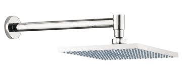

Hi Guys,
I have a crosswater shower head very similar to this one:
every week or 2, limescale builds up in each of the nozels and makes it less effective as a shower.
The only way I know to clean is to remove the head, spray cillet bang through it (which doesn't really work) and then pain stakingly try to clean each nozel with tweezers.
Or when in the shower use my finger nails as the pressure of the shower helps push the limescale out, but this is also quite long to do.
I'm just wondering if anyone knows if there is any other easier way to do this?
Thanks in advance
W
..agreed, white vinegar is usually effective, either soak the shower head in it for a few hours, or use a sprayer and just spray white vinegar into the openings.
Another vote for white (distilled) vinegar. For more potency, dissolve citric acid crystals in the vinegar. You can buy packs of it from ebay and it's chemically compatible with most materials you'll find in the bathroom/kitchen incl metals.
I'm also supplied with hard London water but don't find it such a problem. I think you have a shower head that's particularly prone to chalking up.
Citric acid is also available from home brewing shops.
You may find the problem reduces if you run the shower cold after use, since there will be less evaporation of the remaining water.

If it’s the type that has those rubber nozzles, I have the same problem. To clear it, all I do is give the shower head a scrub with a nail brush while it’s running. Literally doesn’t take more than ten seconds.
White vinegar and a toothbrush specifically for this job
