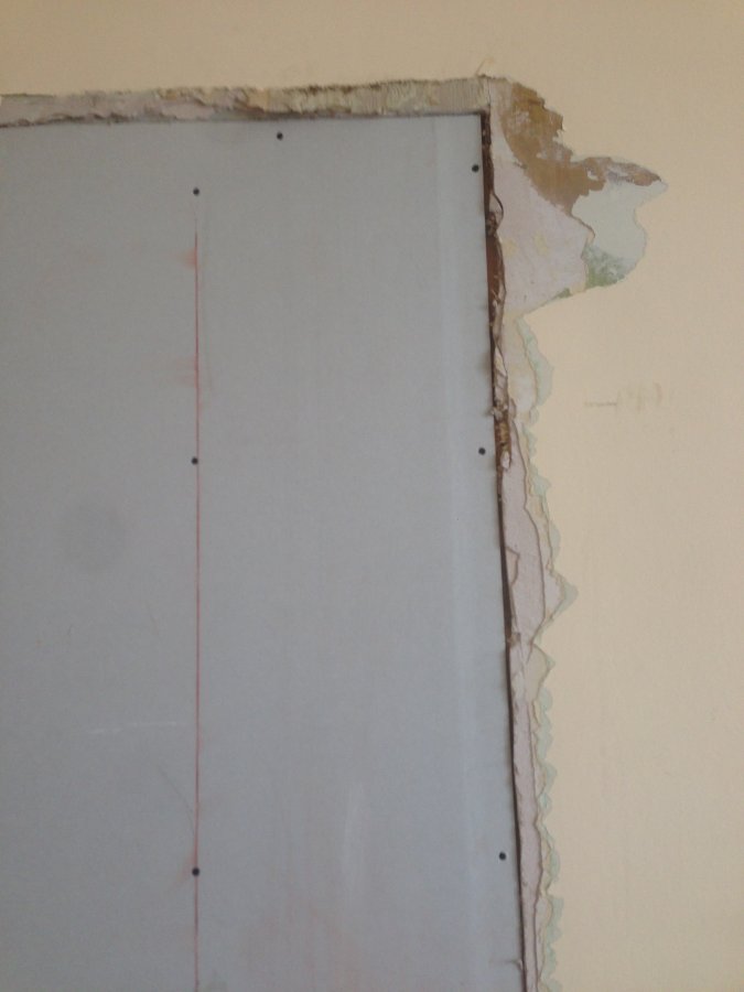

We have moved a door and where the join from the new plaster board meets the original wall there are several layers of old wallpaper. It's a HUGE wall and I not really want to have to strip all the paper. If I get a plasterer will they be able to blend in the join so it is smooth?
Thanks for any advice!

Remove all the paper back to plaster.
Making a join to meet a wallpaper line is nonsense - it wont work for a number of reasons.
Strip the wall and then let a plasterer at it.

To be honest, it'll look terrible doing it the way you suggest,, you''ll notice it for ever more. Bite the bullet, strip the wall, get a plasterer in to flush out the area where the door was, then skim the WHOLE wall,, a far better/proper job all round.
Another point to mention as well, there's nowhere near enough screws in that sheet of plasterboard,,, just sayin!! :))
