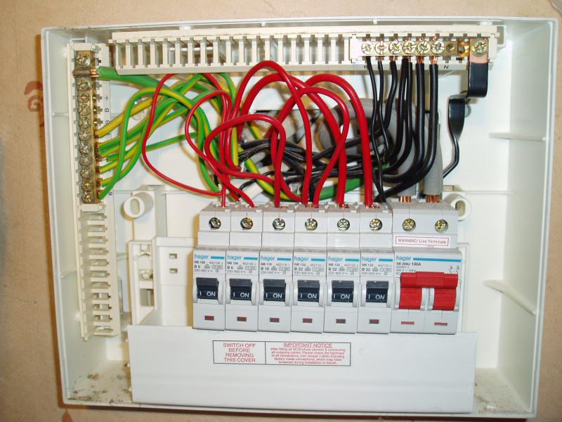

Hi,
I currently have a Hager CU with just a MCB for our shower circuit. I need to replace the MCB with a RCBO (Hager ADN140) as I am installing a new shower and I have no RCD on the shower circuit at all.
This is a photo of our CU as it stands now:
This is how I imagine the RCBO will connect up:
1. Connect "Supply Neutral" fly lead to N busbar
2. Connect "Functional Earth" fly lead to E busbar
3. Connect Live from current MCB to Live on new RCBO
4. Connect new N cable from N terminal on RCBO to N busbar.
Does anyone on here see an issue with this? I have never installed a RCBO before so I just want to check I'm not going to do anything that will cause problems.

4 = NO!!!
the neutral for the circuit needs to come out of the neutral block and be put in the RCBO N terminal..
Everything looks fine except number 4.
You should disconnect the neutral for the shower circuit from neutral busbar and connect that to the neutral terminal on the RCBO.

While you are at it I think you need to re-make those live feeds which have bare copper showing.
Don't forget to isolate first!
Unless my eyes deceive me the current shower circuit is rated at 32a and is either the furthest RHS circuit or the 2nd furthest RHS circuit.
So are you replacing the 32a MCB with a 32a RCBO /30ma B and are you certain the new shower will run at less than 7.3kw (32 x 230v).
You may need to confirm shower rating and then consider if the cable in situ can cope with a large rated RCBO if the new shower needs more than 7.3kw
I think I'd leave them well alone - unless you've got an isolator at your supply origin just make sure you steer well away from them. Don't be tempted to pull the DNO's fuse.
The RCBO you have quoted is a 40A one, what size is the shower cable, how long is it and how is it installed?
Is the isolator switch large enough?
What size shower?

On a 9.5kw circuit, 6mm cable will only just cope with the loading, if its mounted on perforated cable tray throughout ;) and it won't look nice as a result. Run 10mm cable in white plastic trunking (the 50 by 50 mm size will be adequate).

Maybe if the 6mm cable was not grouped with other cables, it would have worked with the 8.5. kW shower, but it's safer to abandon the 6mm, and swap it with a 10mm instead, due to Grouping factors etc.
How many other cables? 6mm² is rated as high as 47A, before derating takes effect.
6mm² will possibly be ok with a shower rated at 9.5kW (@240V) on a 40A RCBO.
10mm² will be better though...
